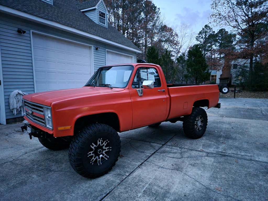

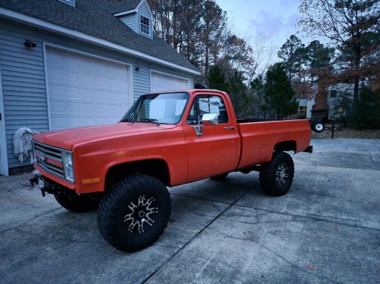

New member...1986 Chevy K20. 350/TH400. Bought the truck as a project for my boys and I to work on. Not sure how far we are going to go on the restoration, but I plan to rebuild the transmission and engine. One question I have...when I accelerate (somewhat quickly) and let off suddenly, there is a loud slamming sound (and you can feel it bang/slam) coming from engine area. Not sure if it is motor mount or transmission. I almost feel like the torque is twisting something, and then it is slamming back down if you suddenly let off accelerator quickly. I checked slop in drive shafts, and both U joints are good. Any ideas?
Thanks for any info...I am looking forward to learning from the forum.
Troy
5,381
8,575
Welcome. Power brake it while you have a friend or one of your boys look over the fender. See if the engine rocks up.
