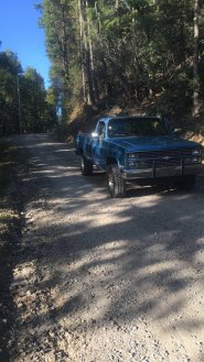

Hello everyone first time poster here, long time lurker. Finally bought my dream truck and looking to swap a built 355 in it. This is local and sounds and looks amazing but I'm worried about longevity/reliability. The guy built it for drags... I drive under 100 miles a week. Says he built it with his father but doesn't trust his dad with the power, claims 450 HP. 3k miles since build. Here's what it's got:
1969 truck block, 4 bolt main.
.30 over w/ dome pistons
Comp. 565 lift cam
2.02 valves / dual springs
Roller rockers
11 : 1 compression
Dual 600 holleys
Ported tunnel Ram
Forged GM crank shaft
1 piece oil pan gasket
Letting me drive the car before pulling the engine. I obviously won't run the dual carbs or the tunnel ram. He has an edelbrock 1406 he will put on and tune for me. Truck is DD and used occasionally on weekends for mud/trail/abuse. Thoughts? Thanks in advance.
