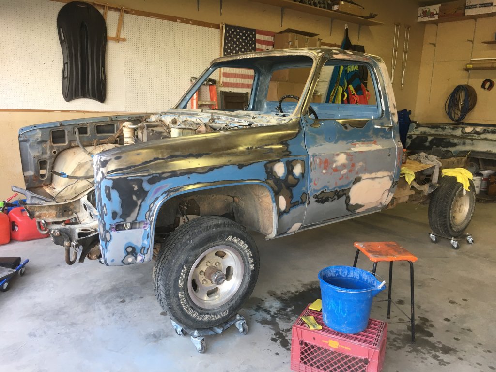

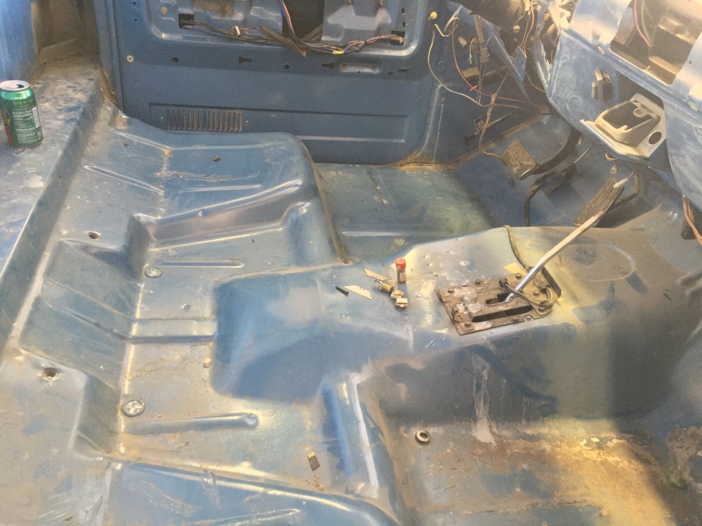

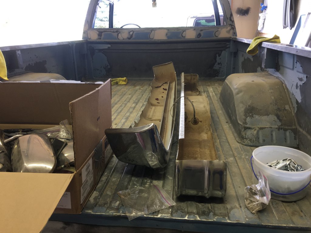

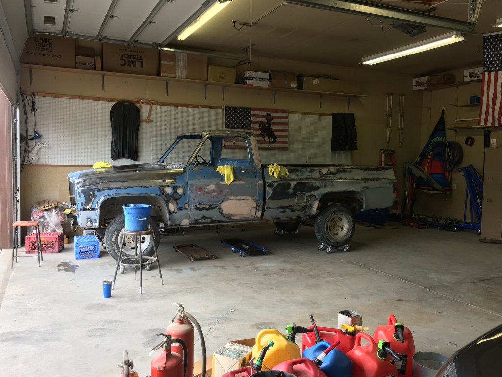

Plans had changed. I traded my 86 for my fathers 1984 GMC K20 Sierra Classic. Much much better condition. Gonna raptor line the bed as well as the bottom 2-4 inches to help protect the truck from dings and dents caused by rocks. We are painting the visible parts of the interior such as the door sills along with the dash. I bought 2-gallons of restoration shop single stage Acrylic Urethane paint. Will that be enough? Also. With the primer. If I prime in and paint it within around 3 days of eachother would I still have to rough up the primer before I paint?
Steak DaQuavis
Mar 22, 2023
Greybull, Wyoming
Steele
K1500
Here she is.
