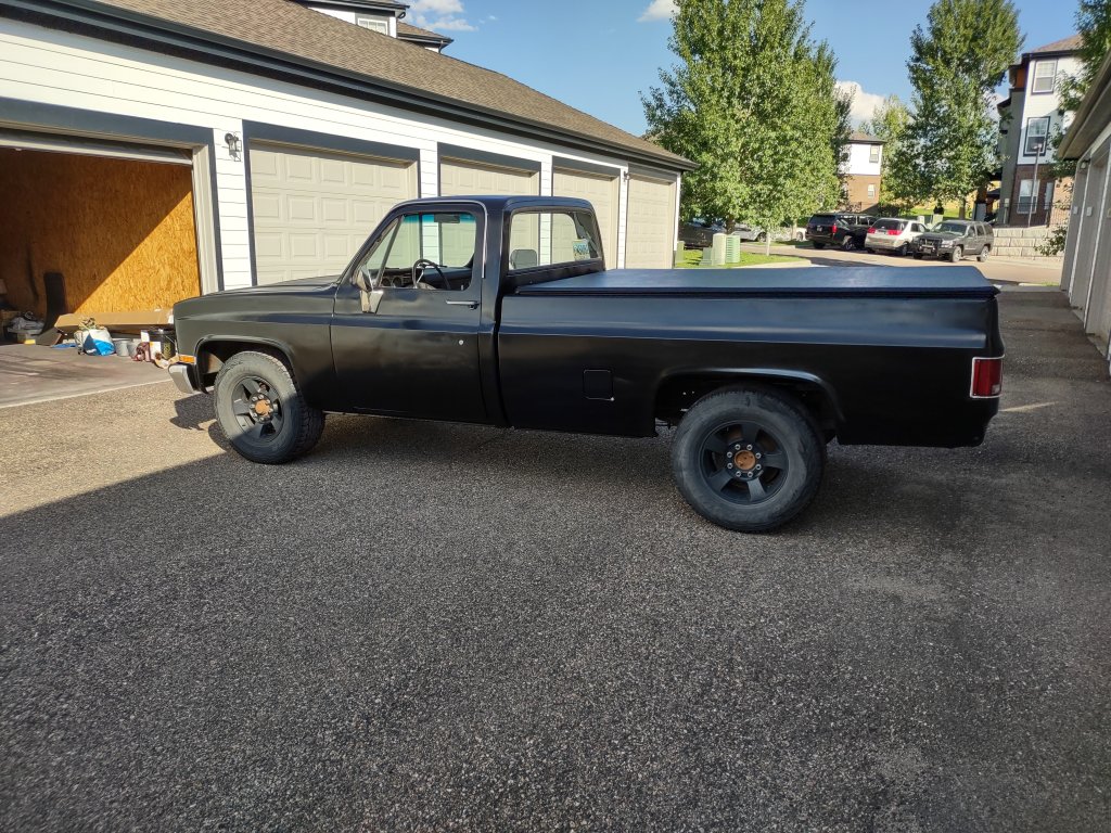

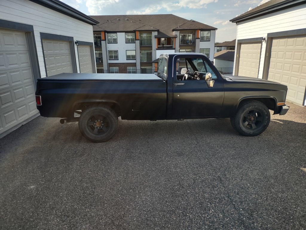

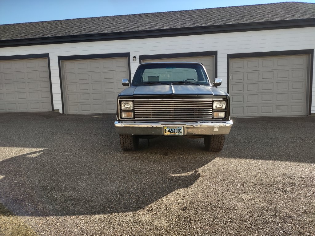

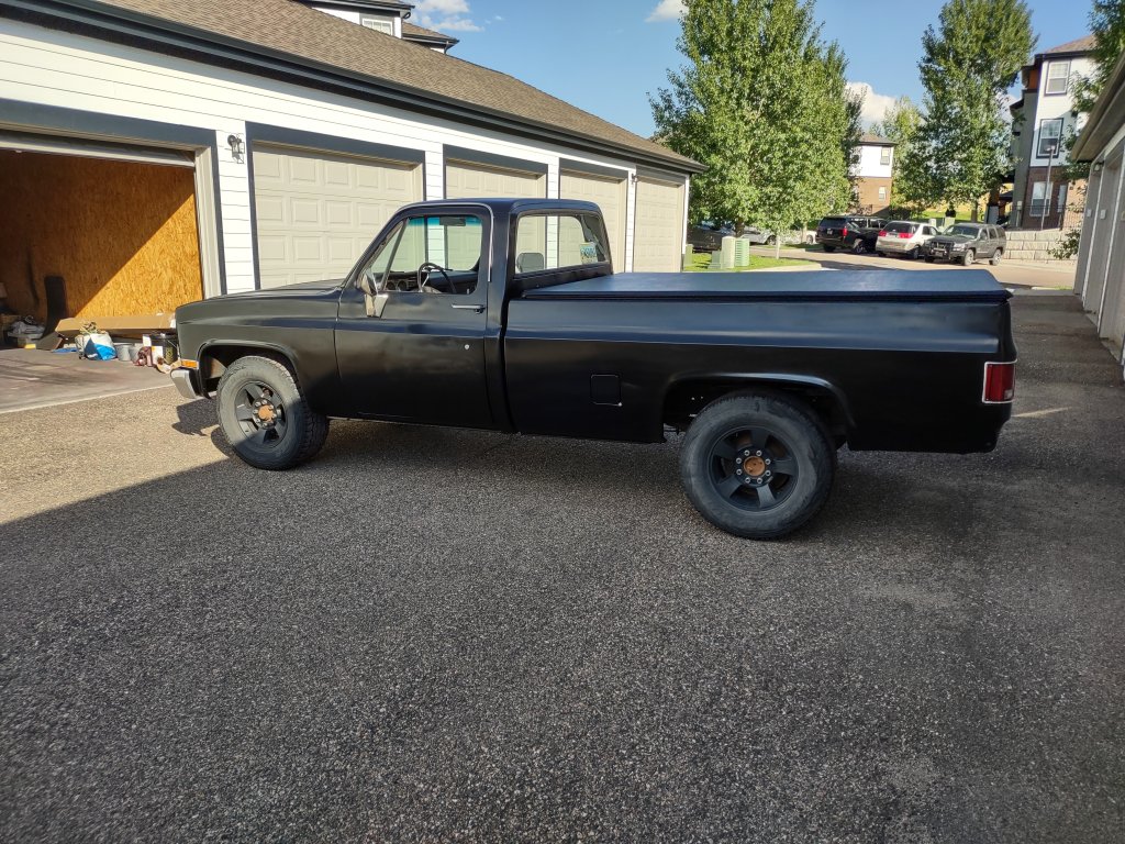

Thank you so much everyone for responding. 70SBUDGET that came out amazing. Definitely going to use that for motivation.
I painted mine satin black, and honestly it wasn't the shade I was looking for. Everything I tried was either too glossy (maybe too much work to finish) or the flat I tried was too....flat. Rust-Oleum used to make a semi-flat that came out like a shop did it. I loved it on my K10. I think I'll use this satin as a guide coat for bodywork, and then roll on gloss black, THEN do the finishing touches on it. Yes I forgot to order one piece of chrome trim up front lol.
