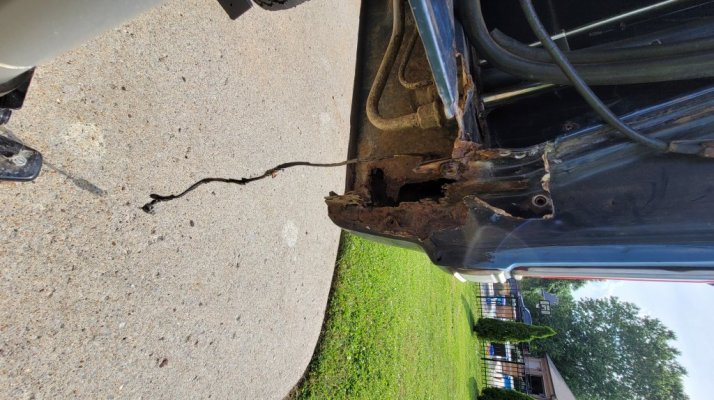

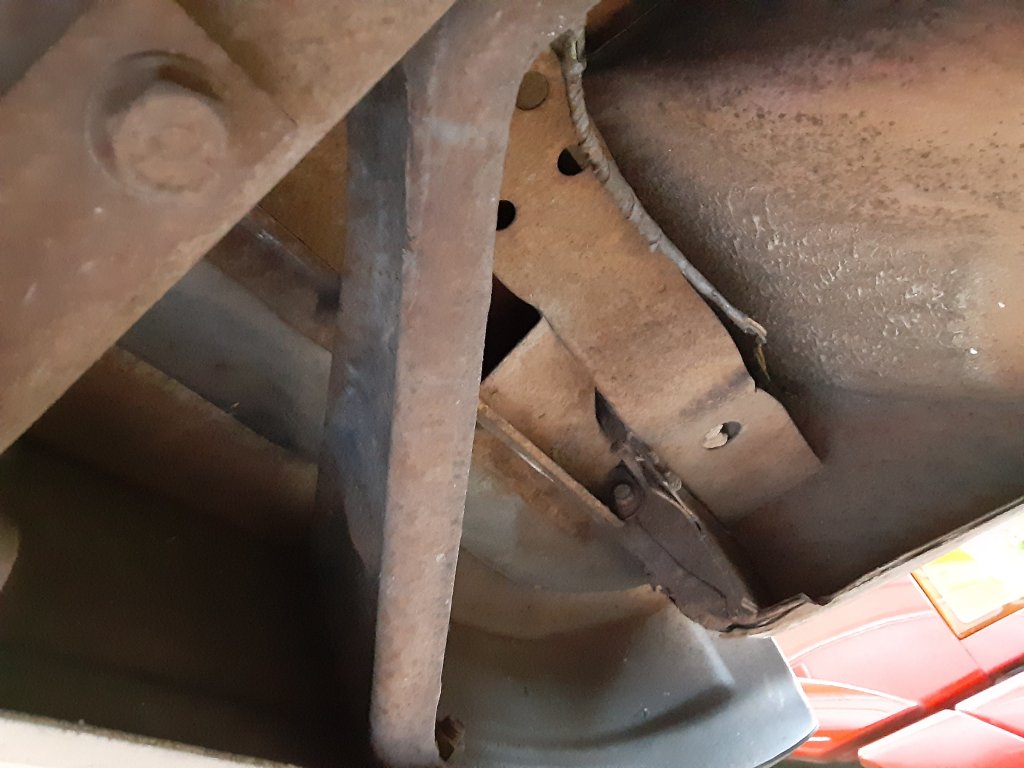

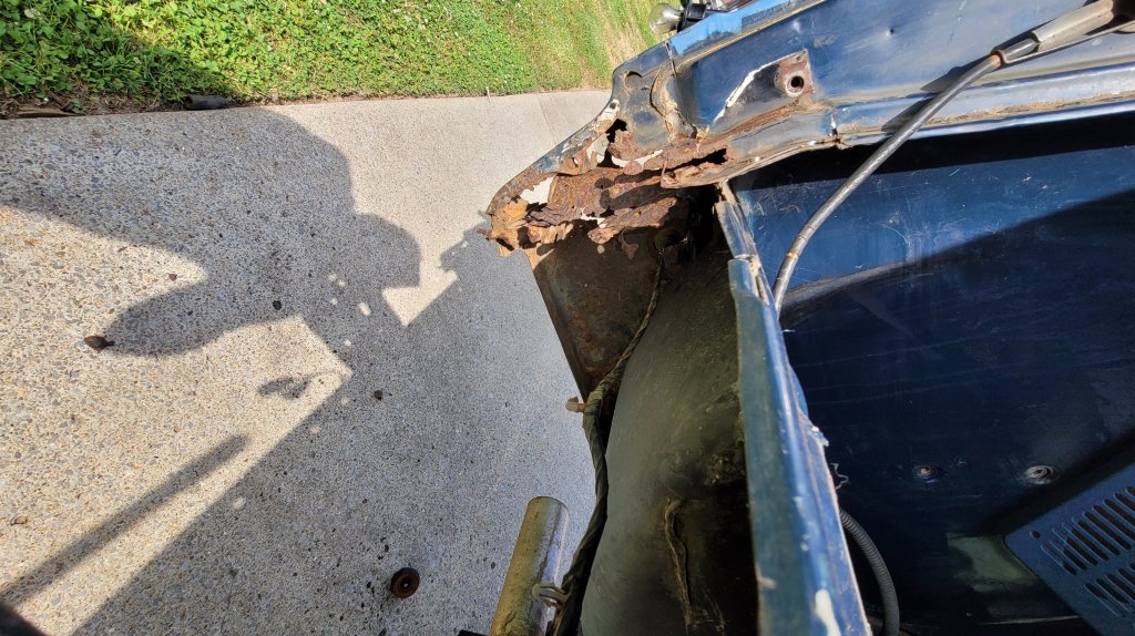

Good evening,
First time posting here. I'm at a bit of a loss, trying to find images of panels where mine have completely rusted away. I have removed the rear bumper, tailgate, and cross-sill on my 1987 Suburban. There is a remnant of the cross sill still hanging on the right-hand side. It will take a bit more work to get it clear without slicing myself up on the jagged rust. The problem is that the rear corners are missing all the inner panels and haven't been able to find any posts or other reference images of what they should look like. To work in new metal, I need to know what it looks like from the rear as well as the underside looking back at the inner structure. I've been searching the forum, but haven't found anything yet. Does anyone have pictures they could share?
Thanks,
Benjamin

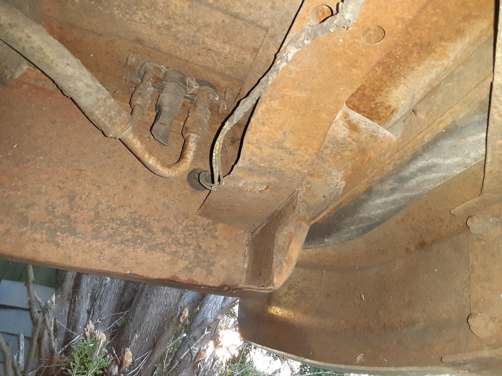

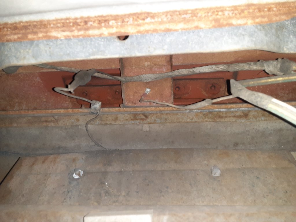

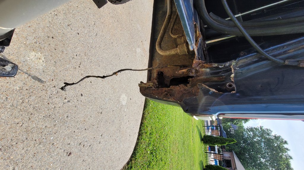

Not sure what you need - hopefully these help. Cargo door rig if that makes any difference.
Britt

That's helpful.
Thank you very much.
