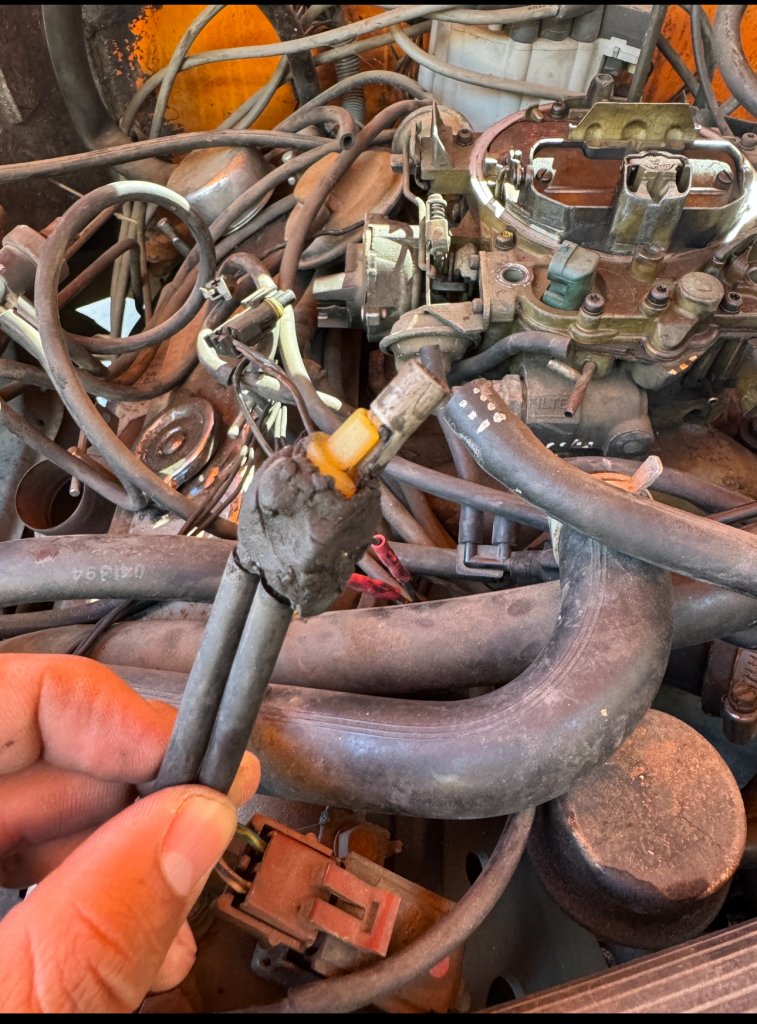

Forgot to add but there is also this random wire I have no clue what it goes to do any of you have an idea what it is ??
