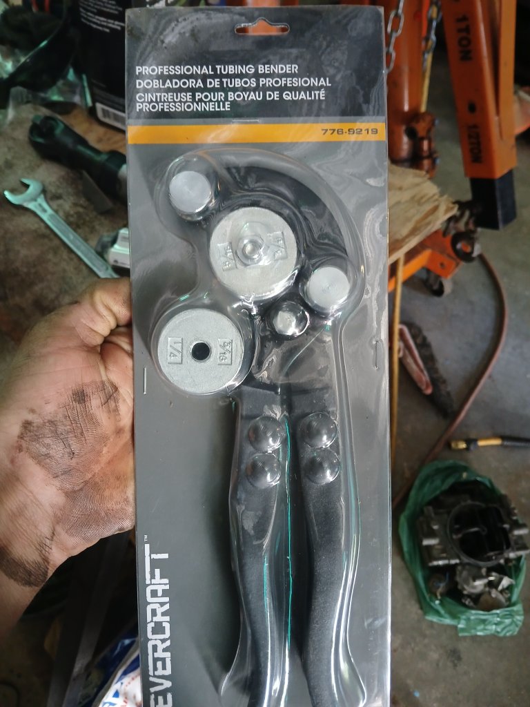

Was at the Napa again and scored this fir $9.29
There phasing out all there evercraft.
