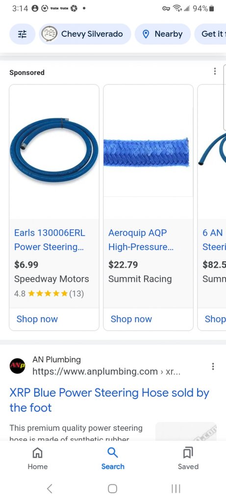

5,420
8,630
Even if they are crimped you can cut the crimp off peel it away and reuse the fittings with clamps. I've always used braided blue power steering hose and AN fittings when I make oil lines,but you can reuse old ends new hose and good clamps. What ever makes you happy. The blue power steering hose is oil resistant,heat resistant,pressure rating is unreal,it doesn't fray and get sharp edges like stainless and its cheaper and east to work with.
