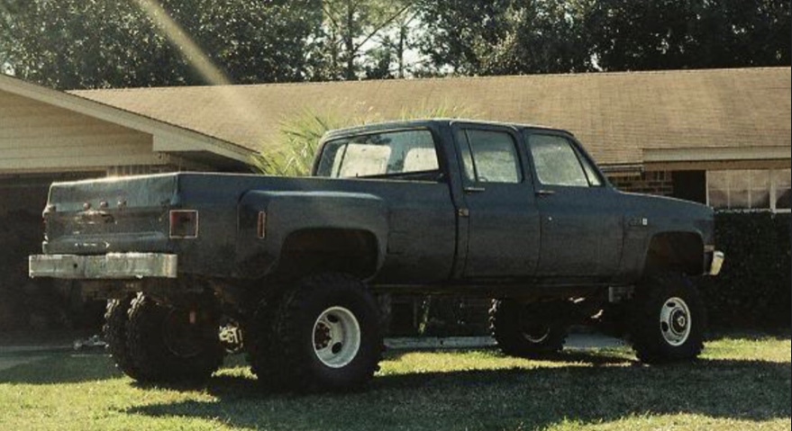

This was the truck I mentioned, factory ‘83 K30 dually with 6x 12.50x38 TSL’s.
wow what a rig. what kind of lift did he use?

The lift was not a kit but a combo of parts. The front had 8” Superlift springs and the rear had the factory 56’s with a (I think) 3 springs added plus a 6” factory Dodge (1st gen) lift block. The reason for that specific block was that it’s cast iron, longer & wider (for bigger footprint on the spring perch), it was flat - no taper and it had a larger bump stop arm cast on it.
This truck still had a lot of axle wrap in the rear presumably because of the massive footprint.
