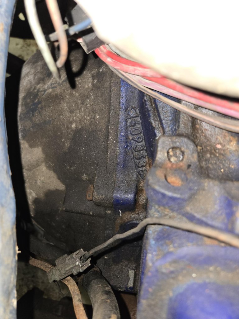

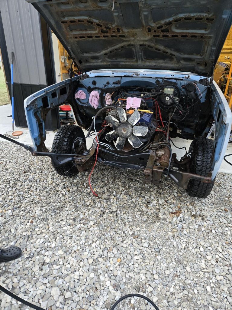

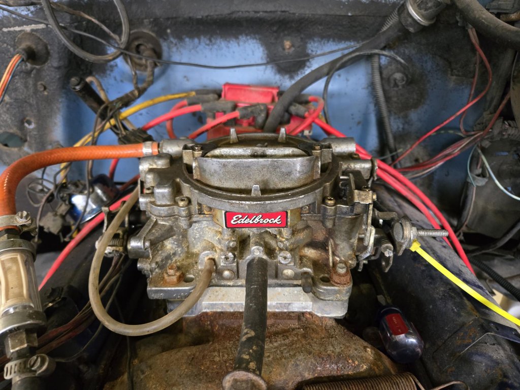

I'm also curious of the drivetrain in this truck as it looks like it has all been completely replaced. The front and rear axle is a 6 lug so it seems those may be the original? The truck was originally built with a 305. That has been swapped to a 350. I have attached pictures but based on the tags and my research it looks like my engine is from somewhere in the 90's as from what I have found online it says most 70's and 80's blocks had a 6-8 digit code that you had to lookup to find out its particulars. It was also located on a flat data area on the front pass side block by the head. There's nothing there on mine. This one has the displacement in the casting on the rear of the driver side. Is there anything else I should look for that may show where this motor originally came from? A couple strange things I noticed are the front vacuum port had a short piece of hose in it with a screw rather than going to the PCV on the valve cover. The small lower right vacuum port was plugged with nothing going to the vacuum advance on dist. and the vacuum line going to shift module was disconnected at trans. This could all have been part of the previous owners doing while working on it. The choke on distributor was also not hooked up to anything. I have purchased an edelbrock electric choke kit for it.

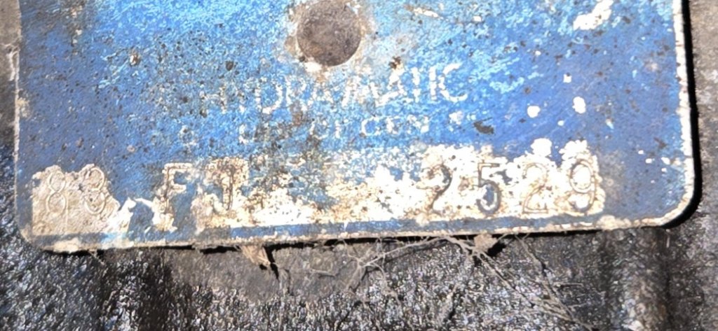

From there it mates to a TH400 auto trans. Also uncommon for this application I believe. The tag on this one says 83 which I assume is the year and "FT" which when I looked that up it just says "rental truck" There is then what I assume to be a S/N I suppose of 2529. Does anyone have any info on what exactly "rental truck" refers to? I'm assuming this trans was pulled from like an old U-haul, Ryder, or Penske truck. If that's the case, I'm guessing it was well used, lol. The guy I got it from said the trans cooler lines were gone and someone had just looped them back to each other which is why he put new ones on. There is no kickdown switch ran to the connector on the side of the transmission. Ill take care of that.

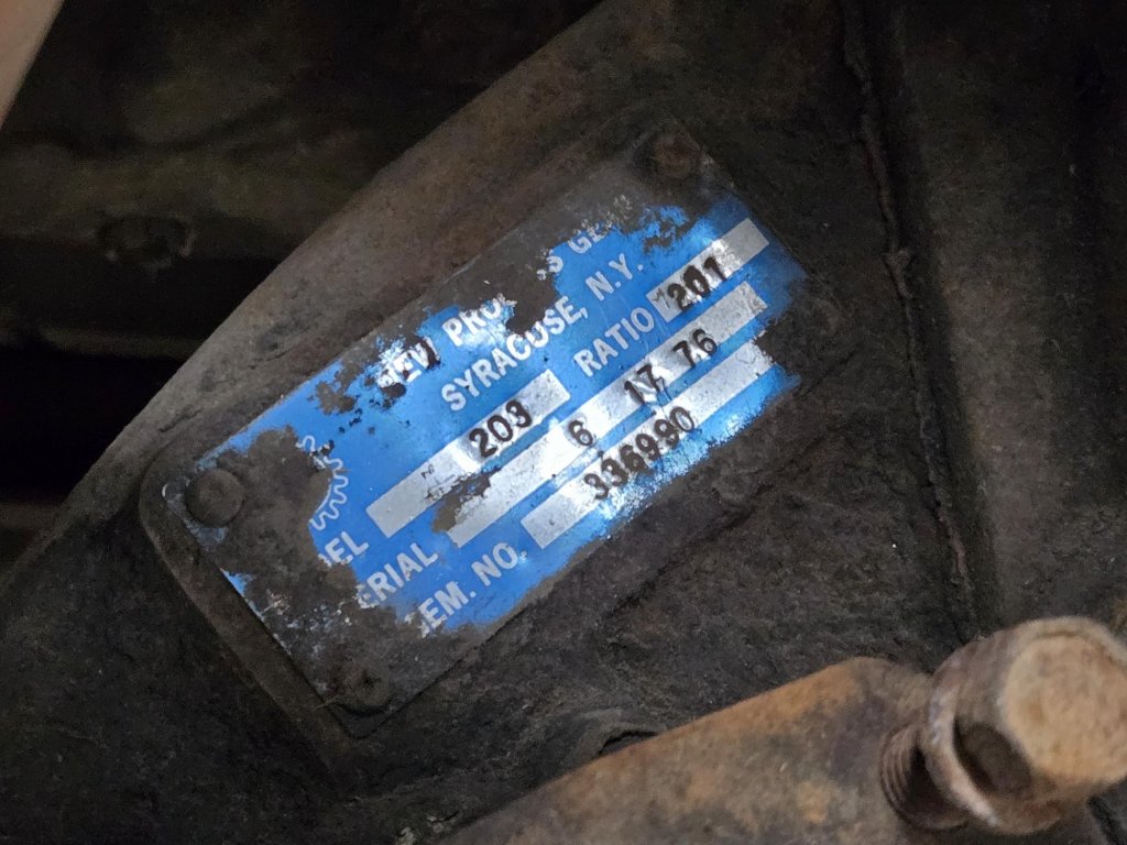

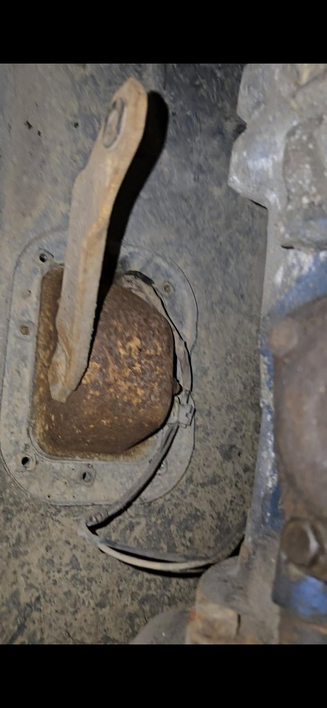

Finally its mated to an NP203. Also wrong for this truck I believe. There is no front shaft in it as the headers that are on the motor are in the way of the front diff. Shaft came with the truck also. I am planning on putting a 4" suspension lift on it so that will likely not be a future issue. The shift lever in the cab is a single 4 position lever that kicks over to the right for Lo. From the research I have done this would have had a 5 position single lever with a very complicated mechanism to operate two rods. There is no linkage on the side of the T-case at all but it does look like it has two keyed parts for actuation. I have seen two lever conversions also. The front hubs on this truck look to be automatic as they just say 4X4 on them. The front output of the T-case spins freely and does not rotate when you move the truck forward or backward. Ill assume it is in 2hi even though everything I've read tells me the np203 is a full time 4WD or AWD T-Case. I have seen there are conversions that can be done but I don't know what to look for for that. Does anyone know how to determine that? The tag on the T-Case says 76. Would I be better off to try and find a 205 or 208 for it. I think that is what it likely came with... I have heard some people say the 203 is pretty bulletproof also. What say the group?

The 400/203 will be ‘79 or older. Technically, the 400 could be newer but the tailshaft required for the 203 is unique to that combo so it’s likely that it was all installed together.

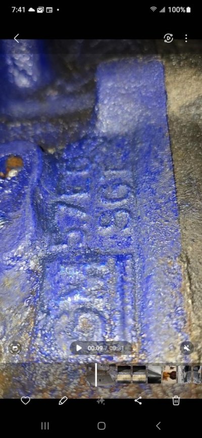

Found a casting number on the back of the block which looks to confirm my suspicion on year but didn't really tell me much. I was hoping to find what it originally was built for but I got "14093638...350...87-95...2 or 4...Roller or flat tappet cam, one-piece rear seal" Pretty vague but also pretty impressive there was s system in place to try and track this stuff when the general was putting out hundreds of thousands of engines each year in all different applications. So I guess ill take what I can get. Not sure it matters too much at this point as I just want to get it to a point where it can be driven semi regularly and be reliable.

I would have thought that any 350 "from the '90s" would not have the hole in the block to accommodate a mechanical fuel pump, those motors should have been either TBI or TPI, not carbureted.

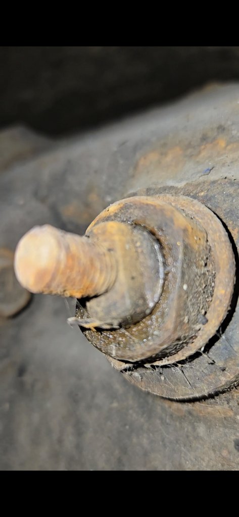

Uhhh, no. No block off plate. There simply is no opening in the TBI block. Someone please chime in that knows more than I do here, there may have been more than one version.
But this pic I just crawled under The Truck to get, this is looking straight up at the underside of where the mechanical pump mounted on the older blocks. The untapped bolt holes are there but there is no opening and no plate.
