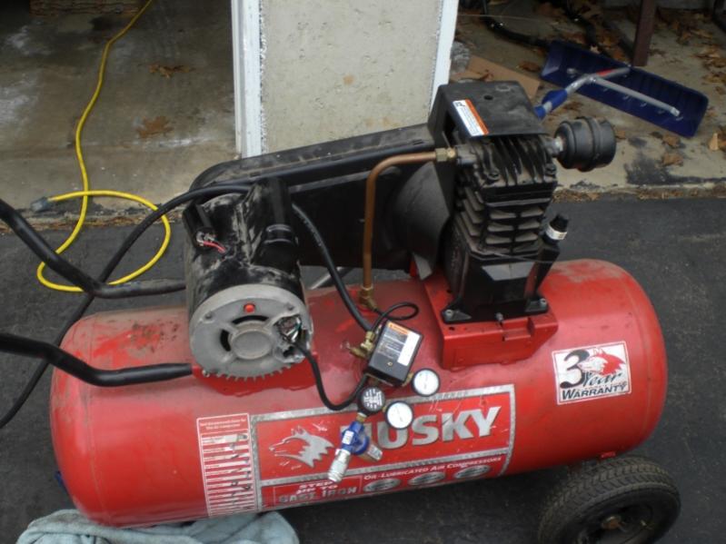

I have a Husky Air Compressor model T63BXCCT. It is an oil lubed 110 v belt driven compressor, something like 33 gallons. Last fall the compressor started popping the circuit it was on when it started to run. Either first time it ran for the day or when it kicked back on during use. Now it instantly pops the circuit or it will make a little noise and try to turn but then pop the fuse. I took the cover off and can easily move the belt by hand.
It has two what look like capacitors on top of the engine. One is black and the other grey. They have 4 plugs but only two are used. I checked all the connections and there is no corrossion. I applied dielectric grease and tried swapping the plugs on these two capacitors and keeping them at a diagonal like they were, just opposite. Same result, just pops the fuse. I will try to post some pics in a little bit. Any ideas?

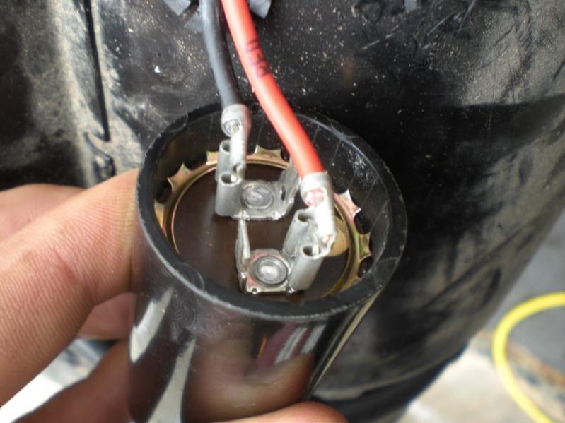

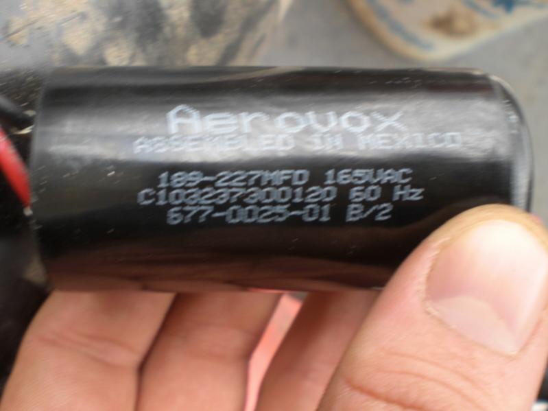

thanks for the replies. I've checked it on several different circuits including a new 20amp and exact same results. At first I thought it had something to do with the temperature so i brought it inside where it was 70 degrees and nothing is different.
I've been searching the web and this is what I've come up with so far:
Unloader valve, if i relieve pressure in the tank and it runs then the unloader valve is bad. Pretty easy and I will try tommorrow.
Could also be the starter capacitor. I'm assuming it is one of the ones on top of the motor. Very easy to get to and swap out. I found a place called Graingers and they have a store about a half hour away. I may take a drive tommorrow and just swap out the parts.

One more thing. I tried taking off the plastic cover for the belt and turning the belt manually. It turned easily and after that I fired up the compressor and turned it a little by hand to give it a little help. It ran really slowly barely turning the belt for 10 seconds and then tripped the breaker.
That should tell you it's not the hard start capicitor. Can you tell if it's the motor or the Compressor that's getting stick and hard to turn? I'll assume it's the motor since it trips as soon as it gets stiff. It might need a new motor if it's an oilless motor. But it sounds like the motor might need oiled.
