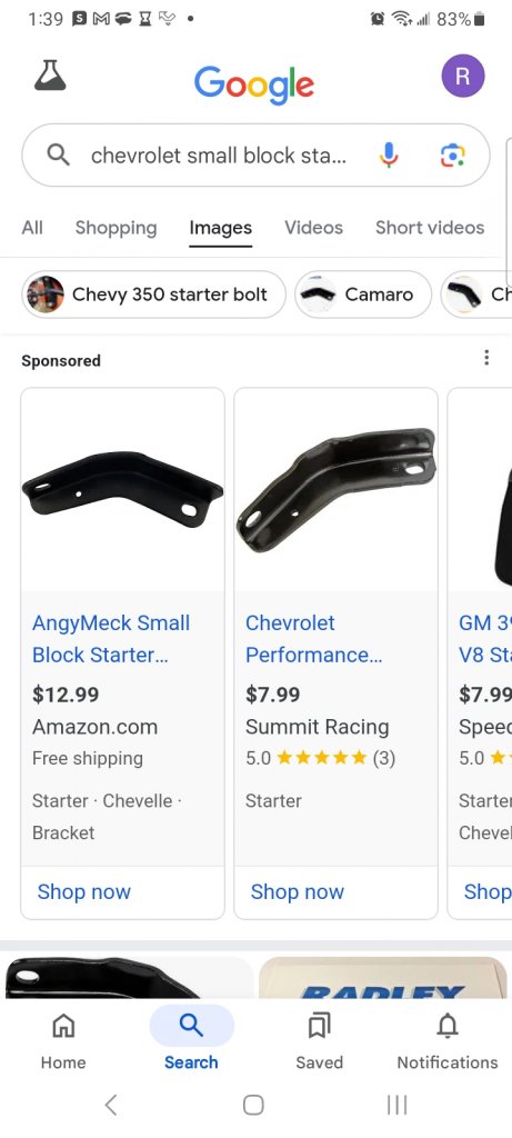

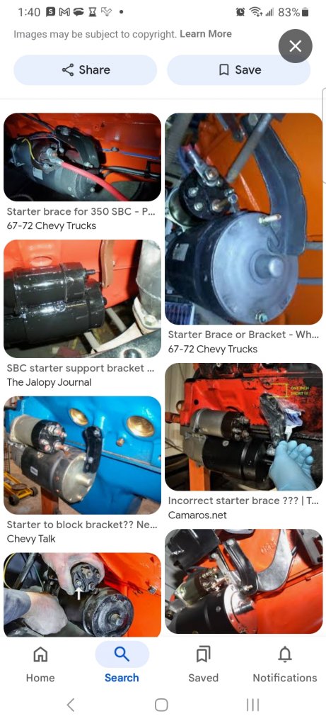

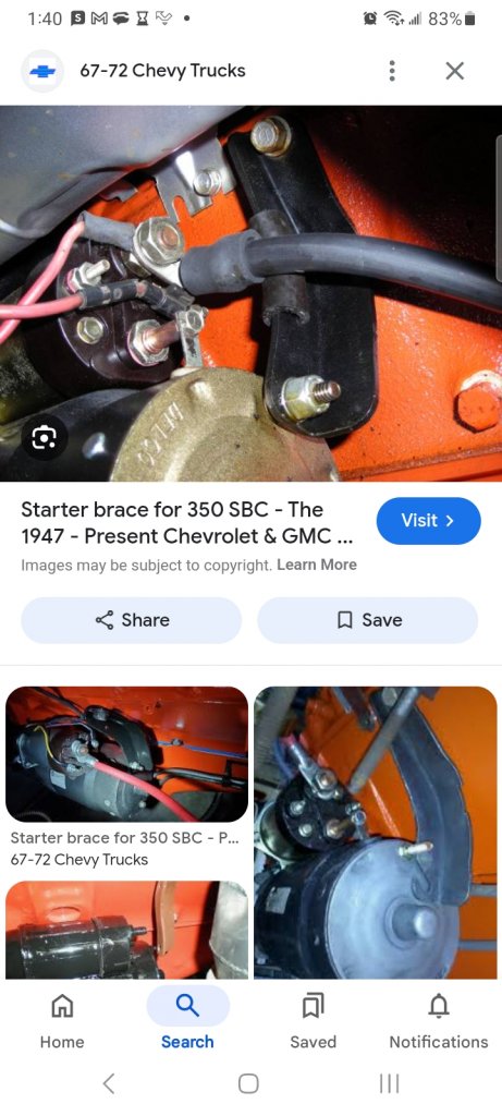

One thing to remember is GM heavy starters need that rear torque strap employed or the starter can get all wonky and tears teeth up on the flex plate.
Now thats important to know - since mine did not have that. What does the strap attach to?
6,259
10,640
Bolts to the back of the starter and then to the block. I think it's a very important piece,others don't think so. Have someone crank the starter sometime while you lay on your back and watch the starter twist.You know a triangle is a very strong shape,that bracket creates a triangle 2 attachment points at the front of the starter 1 at the rear. There are 2 versions. 1 for 168 tooth flywheel 1 for 153 tooth flyweel,probably have to order one online.

I got you a couple of pics.Ive had the argument too many times on here. I'm not going to get into the debate again. Putting the brace on supports the starter way better because now it's triangulation not just 2 starter bolts in the same plain.As I said before watch a starter with no brace flex when the starter is engaged.I am positive,that any of the broken starter nose cones or cracked blocks at the starter location that I've seen were missing the brace. If you aren't running a brace,Google Chevrolet small block starter brace important or not. Do some reading make your own decision.
