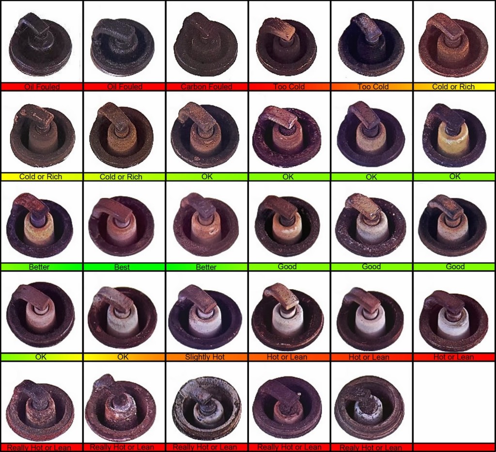

They also could be really really old lol
Blackbeard44
Jun 14, 2020
280
258
Washington State
andy
6.0 LS
heres a good chart for future reference
