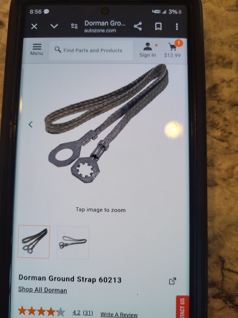

This is the ground strap is the one we installed. If this is not correct what do you recommend
That strap is supposed to go from the back of the cylinder head to the cab firewall. You need a minimum 4AWG wire from the alternator bracket or block to the frame and then same gauge from the frame to the Battery. That strap is not going to flow nearly enough without massive amounts of resistance(heat).
