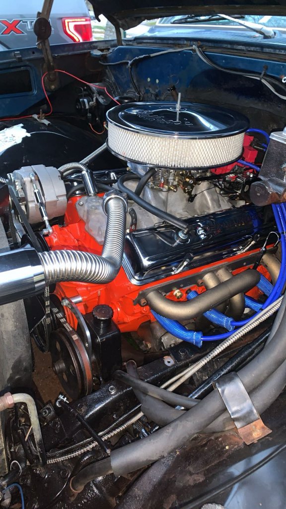

I ended up buying the carb anyway due to the steal of a price I got it for, so will see how it preforms, worst case I can sell it for at least what I paid and can go with one of the other options mentioned
(At least it looks good on there lol)

Still has the gold zinc linkage so it's old stock and probably has the good choke too.
Well that’s good news! Will have to see how it works out, doesn’t need to be a crazy hot rod anyway just want a good runner with a little bit of pep to it when wanted
