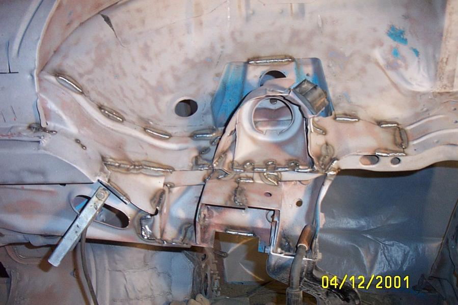

i have the same blaster
i used it to blast the underside of my vega it worked good
i hated the dead man i broke it off and just used the air shut off to control the blaster. it took about 10 hours total to blast the underside and engine bay of the car. here is a picture i done some welsing before i painted it.
