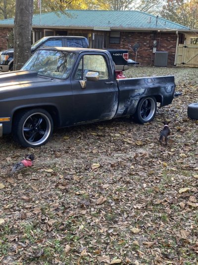

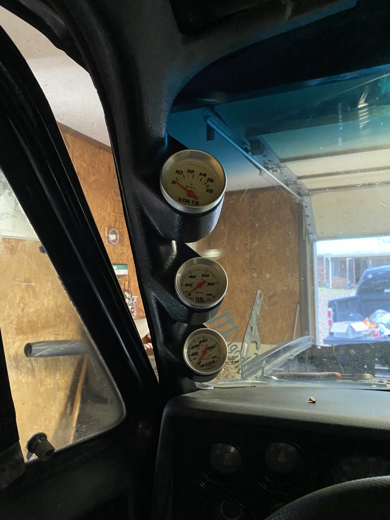

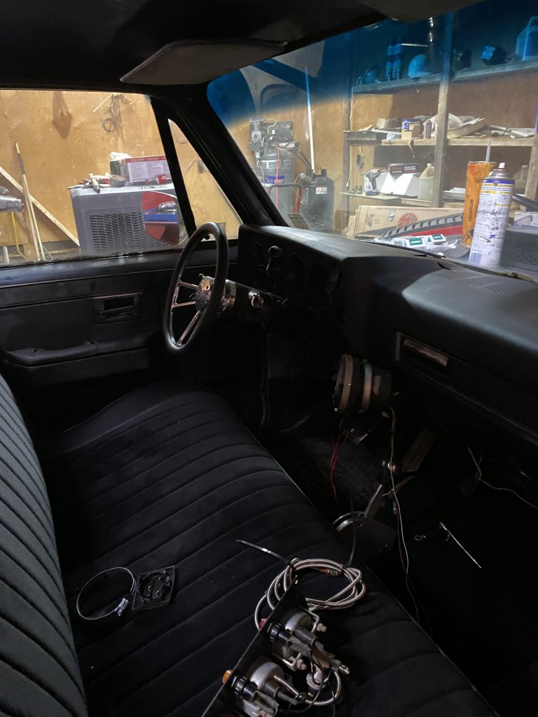

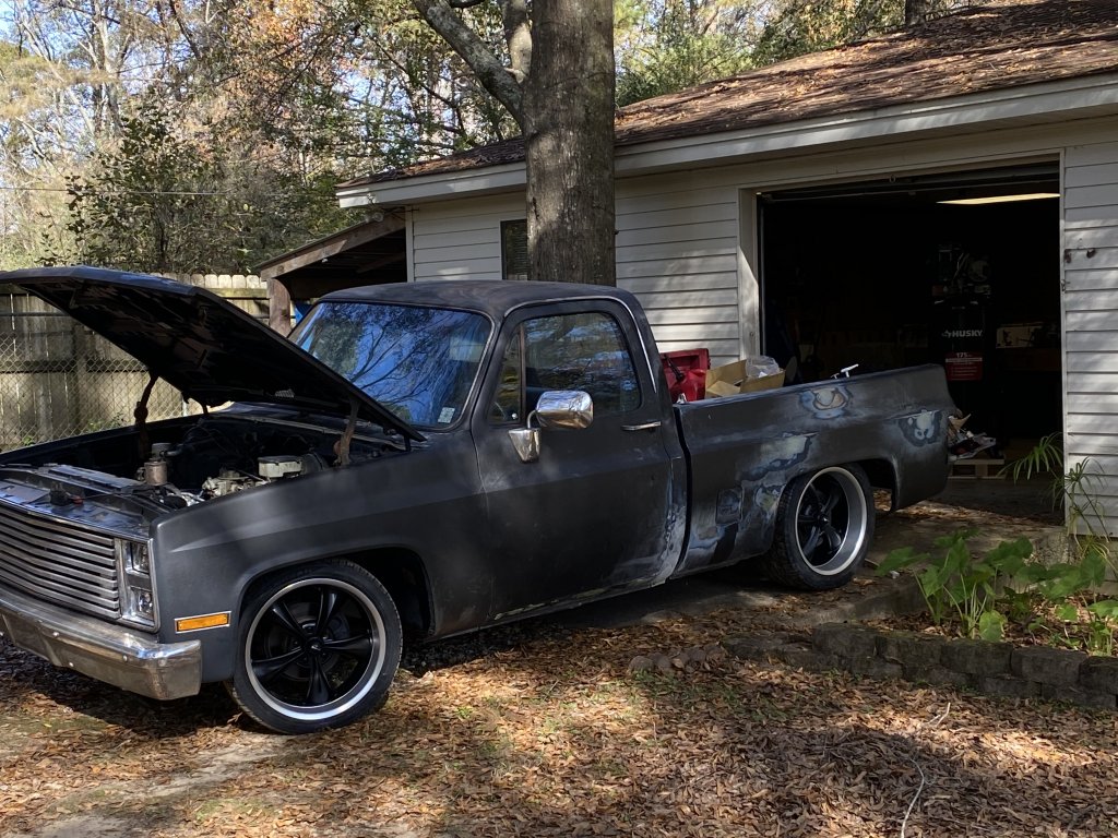

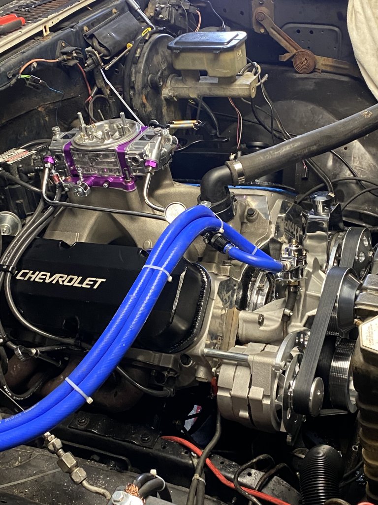

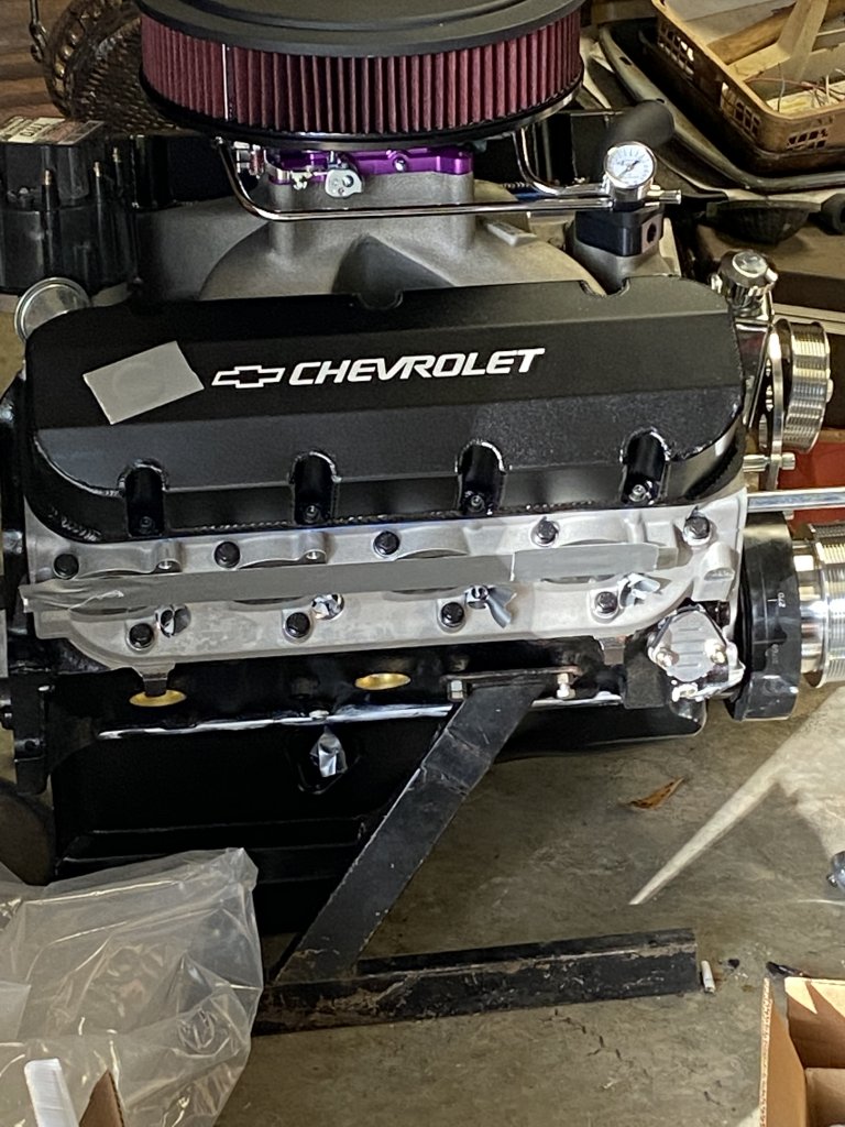

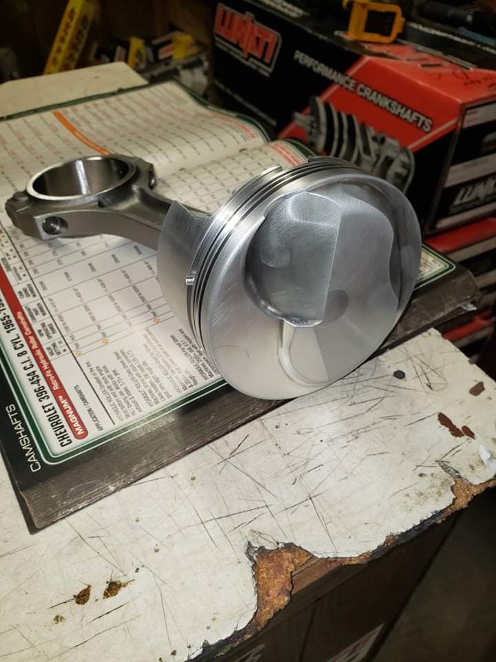

Just few pics and info of my slow build of my 83. It has a 497 stroker aluminum rec port heads Bullet hyd roller 10.3:1. Running a th350 with a 3500 stall atleast for now. Going to swap it over to a 4L80E eventually. 12 bolt rear with posi with 373 gears. QA1 torque arm rear suspension lowering springs and drop spindles up front. Derale cooling fans MSD ignition system now.

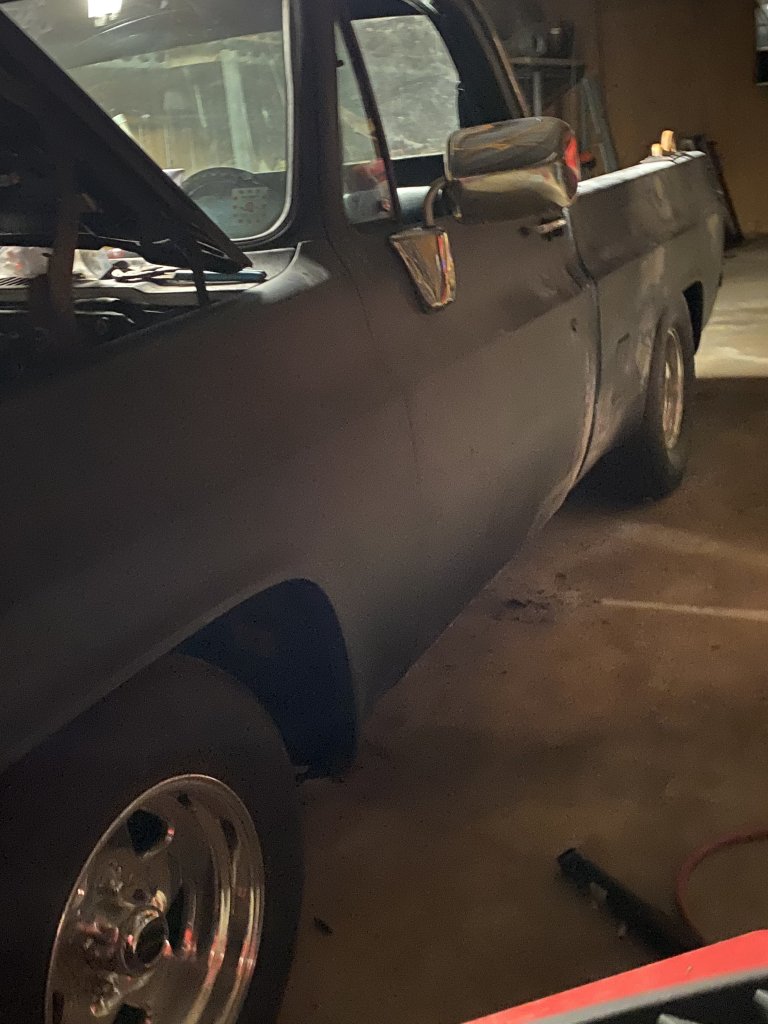

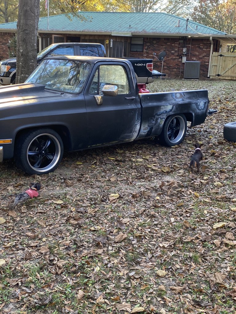

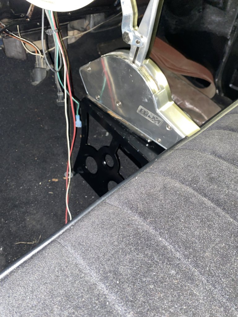

Few more

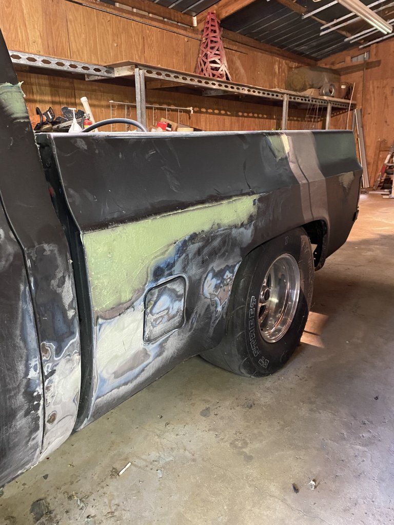

Man that thing is gonna be a blast to drive, nice build. Body looks clean too, just needs paont, I'd say you're getting there for sure. How long have you been building this truck?

Thanks guys, I’ve been building on it little over a year here and there as time permits lol. I run flatbed over the road down to Laredo and back to Birmingham/ kinda burned myself out on it a little but not giving up! Been fighting a super rich at idle problem finally ran it down today. My brodix intake doesn’t have a slope built into it is it had my carb tilted back and was pulling way too much fuel into the bowls. Got a wedge spacer order and hopefully that’ll get it took care of
