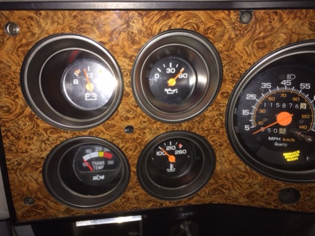

Thanks guys. Glad to hear it will fit. Looks like on 1991 I just lose the fasten seat belt light and the brake light. No biggie on the seat belt and for the brake light I'm sure I can rig something up. The idea of using a tach from a late 70's is intriguing but I really need the one with the fuel gauge - the PO of my burb installed a trans temp gauge in the empty small hole and I would hate to lose that - he did a pretty nice job of it!

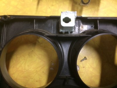

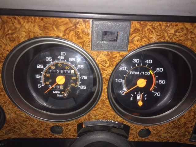

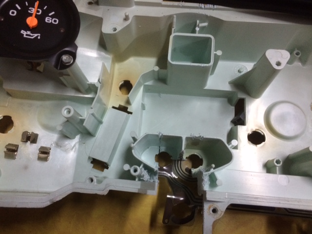

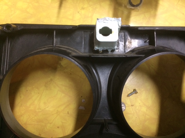

I finally got this unit installed and it works great. I'll take a you tube vid and post the link here soon. For the brake like I had to get creative - I couldn't eliminate "Service Engine Soon" or "4 wheel drive" (well didn't want to) so I added a break light at the top of the dash in between speedo and tach. I think it's where the glow plugs light is for the diesels. I used the original lens for the brake light and I used one of the plastic structures that holds the light socket from my extra cluster which I glued on to back of the panel. Cut a hole in the panel to match and then I used a plastic bezel from a fog light switch on the outside to clean things up a little. It's a little hoaky, but it works.
