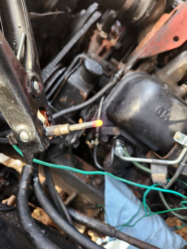

I did a resistance test on GPs 7 of 8 are good. The 1 bad one is on driver side.
I accidentally pulled one of the wires that connect to GPs loose on driver side, so I redid the ancient and probably original connection with a crimp connector and heat shrink.
Tested, 12 volts
Passenger side, no volts... so I redid that connector too same as driver side.
Interestingly, the driver side connection has the GP relay wire, a wire off the GP controller and another one haven't traced it, all twisted together and part of the connection. I dunno when I redo connections I put whatever was there back where it was with a fresh connection.
The passenger side however only has the big wire coming GP relay. Then tees off into the 4 GPs. Nothing else.
Here's my problem now. I get voltage on both sides. But no amperage on passenger side.
I tested the GPs with jumper cables and battery, clamp on body of GP, grounded to battery, hot wire to positive and touch the connector end with other side of jumper cables. 7 of 8 get hot. Great. Same thing, instead using the trucks harness. So clamp to GP body, ground to negative, and now trucks connector on the GP, turn key, solenoid (or relay) kicks on. And she's hot. But only on driver side. Not passenger.
I jumped a wire (badly) from driver side GP connectors to passenger side to test GP again, with jumper cable set up.
She got hot. Not as hot as driver side but like I said, it was a ghetto jump set up, lotsa of losses

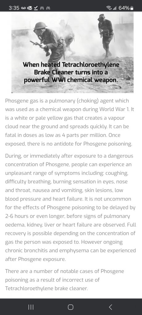

Don't burn brake clean it creates phosgene gas,not all brake cleaners do but,just don't burn any and there won't be accidents. Don't clean parts your going to weld with it either. This has been a public service announcement. Now on to the diesel not starting,cheaper than wd40 and works good for me is kerosene in a plant misting bottle.

I dunno about stock but. The pink n blue wire that tell the solenoid to click. And the 2 big wires coming out to go to each Individual bank of GP... well they go I to this black connector. Why? I dunno.
But I took that apart, and the crud man. It was nasty.
Cleaned that up. Set up my jumper cables expecting not different result. Well, I'll be. She glowed. Glued. Glowedidided.
Put everything back in, turn key and oh man what a sweet sound.
Its a death trap coz 2 injectors are bubbling and leaking on the exhaust manifold but that's small peanuts compared to what I spent the last 3 weeks trying to figure out. Snug er a lil nd that's that.
So moral of the story I guess... check your connections? Simplest answer is often the easiest? I dunno. I couldn't be happier right now.

@Ricko1966 , interesting read.... I think I'll forward it to my buddy whi likes spraying brake kleen on welds as they're happening lol.
5,624
9,204
It's not all brake cleaners,I just make it a personal habit to not heat any,so there isn't a chance of a mistake someday.
