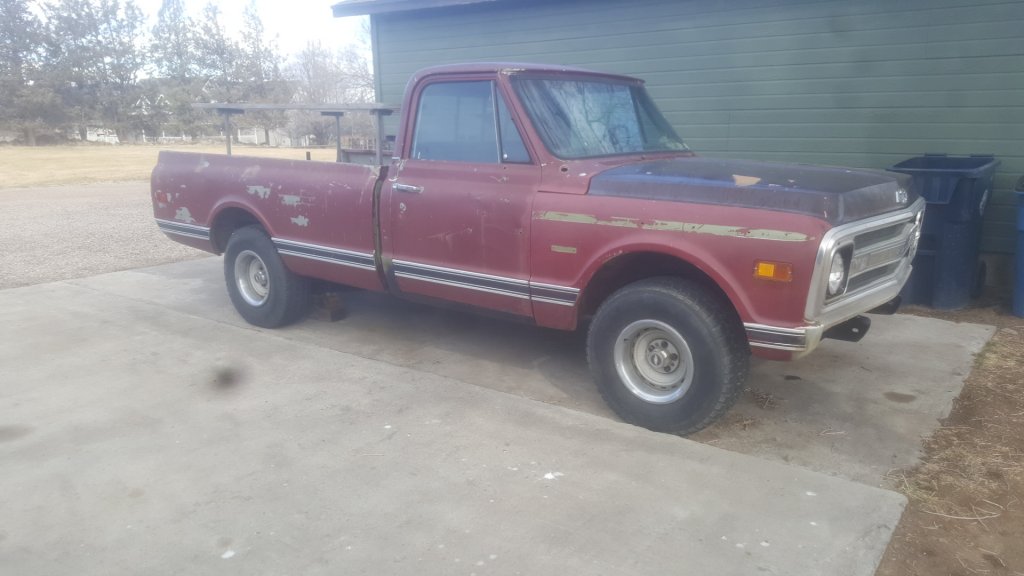

Dmack
Mar 13, 2019
329
420
Central OR
Dave
On my 70 C20, I picked up a 1984 c10 parts truck and just swapped the entire front crossmember (a c20 would work the same). Any squarebody C10 or C20 would work. It's like 12 bolts, disconnect the steering, and drop.the entire front suspension out. Sometimes you have to open up one hole on the frame. Roll it under yours and bolt it in place.
Pretty simple way to get more modern suspension and replacement parts are available at all your local parts stores.
I also swapped in the engine, transmission, power brake system, power steering system, rear axle, seat. and misc parts. Bought the parts truck, kept what I wanted, and parted out the rest. Came out with all the parts I wanted and $100 ahead (doesn't Usually happen that way).

Man you cannibalized that MO FO - Good job!
Dmack
Mar 13, 2019
329
420
Central OR
Dave
It had been sitting at a farm for several years. Owner passed and family sold it to me. Got it running on starting fluid, so bought it for $500. Bypassed a locked up front brake, and drove it Roadkill style with no front sheetmetal, battery bungeed to the front frame, and running off a gas can in the bed with a fuel line taped over the cab. Just wanted to make sure it ran, shifted, steered, and stopped. Then tore it down.
Enjoy your project.
