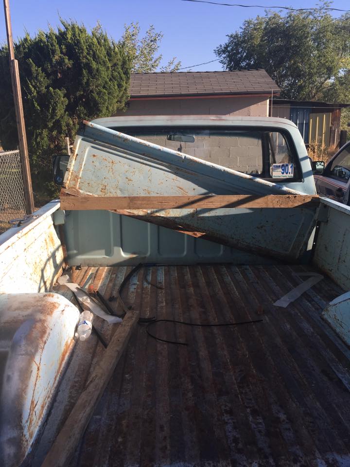

I have removed all the screws holding the panel. The 2 above the gas tank took a while. My question is: should the panel now come right out, or do I have to loosen up the side panels too? I've tried moving it but it doesn't seem to want to move. It does wiggle a little. I must be missing something. Once I get it out I'll take it to the sheet metal shop at work and straighten it out. Has anyone ever removed one of these?

I've never tried it, but I guess it could be done. You'll need to spread the bed sides out since the front panel tucks into the sides. It could also be the seam sealer at the joints of the panels holding it in.

Bed sides definitely need to be spread apart to get the rear panel out. To get them spread apart far enough though would probably require most of the bolts to be removed from the sides.

This is off my 77 donor, looks like you definitely have to spread it apart at least 3" at the top then you might be able to slide it upward, you did get all the bolts off across the bottom right?..

I did get all the bolts out. I was hoping I could drop it just enough to pull it up at an angle to clear the sides. Oh well.....

Nope, to do that you'd have to drop it down about 6" to clear the stake pockets, but you could take one side off then it would come right out.

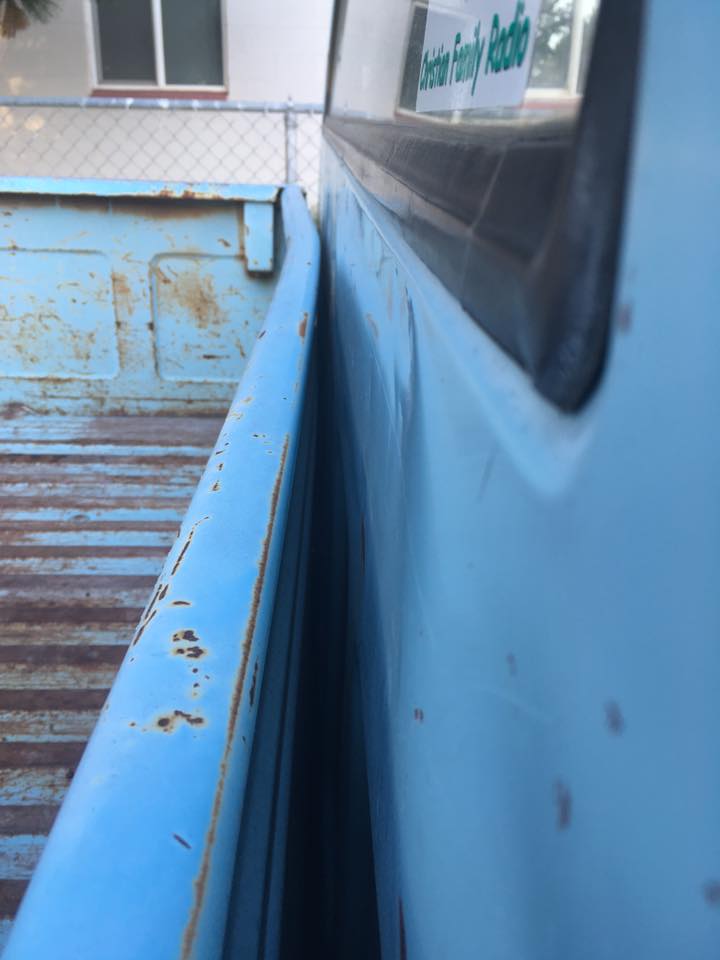

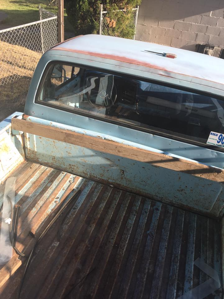

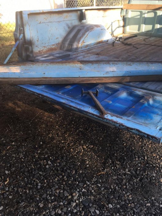

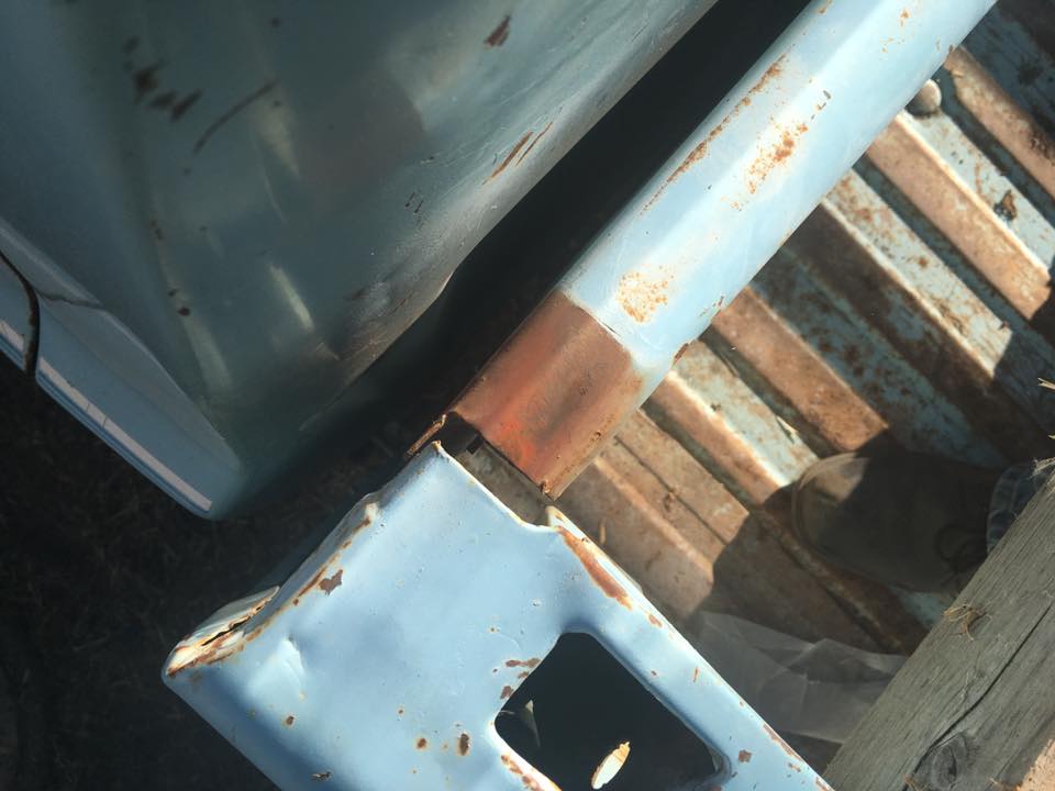

I loosened the 4 fender screws a little between the tire and the cab , and then took a 2x4 which I cut about 4" longer than the inside of the rails. Using a hammer I slowly wedged the wood in until the rails cleared the panel ends. Pulled it, straightened it, covered it with rust treatment, and tomorrow I take it into our sheet metal shop to do a little more straightening. The last pic is after I straightened the top rail. Before I did it there was a gap of 3" between the rail and the wood. Now it's an even gap all the way across.
