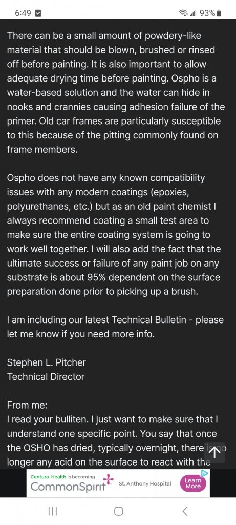

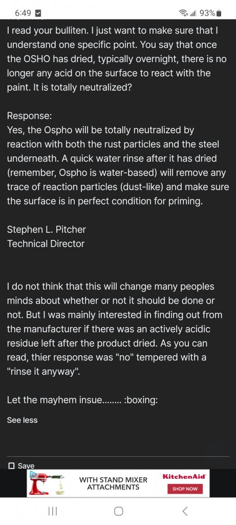

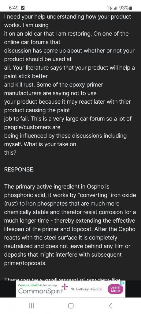

I'd hose it with ospho again,hand rinse it with water and a rag and epoxy it the same day. Preferably I'd use a primer I could shoot over the ospho. I'd shoot a test panel over the ospho. Here's some screenshots from another forum. I prime right over dried ospho,but that's inside doors,trunks,wheel wells,and floor panels using enamel.

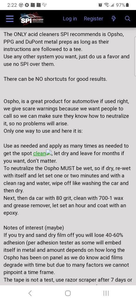

Check with SPI they'll tell you rewet it with ospho and I'm not going to try to remember and quote but check with SPI,you don't need to reblast it. I found it,posted a screen shot,looks like reblast is not the answer do to adhesion loss or I would assume so they only referred to sanding,but I imagine sandblasting is in the same category.

I talked with SPI, as well as a couple other different makers of epoxy primers and it always comes back to "it SHOULD be ok...." if I wet it and power wash it off. Eastwood was pretty adament to blast or use a sander (which is a PITA to get into the nooks and crannies). The only 100% guaranteed fix is to just blast it again. There were areas alot more seam sealer came out and there was a line of very light rust down in a seam, so would like that all thoroughly cleaned out too. Guy who does it for me does my powder coating. His blast-bay is the size of a semi w/trailer. Said he'd hit it again for $50. Cant beat that but still gotta waste another 7 months before this worthless zip code has human weather again.
Depending on how $$$ is come Spring, Plan B is to dip it and then e-coat it. Doesn't get more thorough than that.
