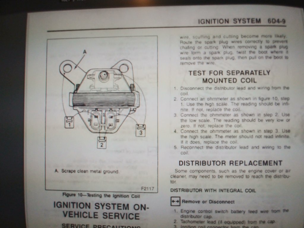

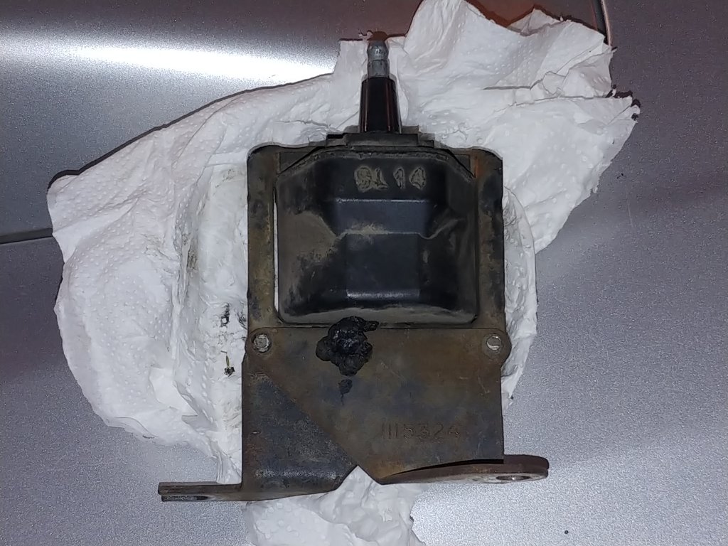

EDIT: Just tested the coil, it reads "open" between terminals which should have close to zero resitance. Once removed it looks like it has melted!
Do you think this is a root cause, or maybe a side effect of some other failure?

Coils do occasionally die. I had one go terminals up 2 months ago. Coil just died. No rhyme or reason. Yours likely shorted internally which caused the heat to melt it just before it opened up.
IIWY, I'd get a new GM Delco coil from Amazon and call it a day.
