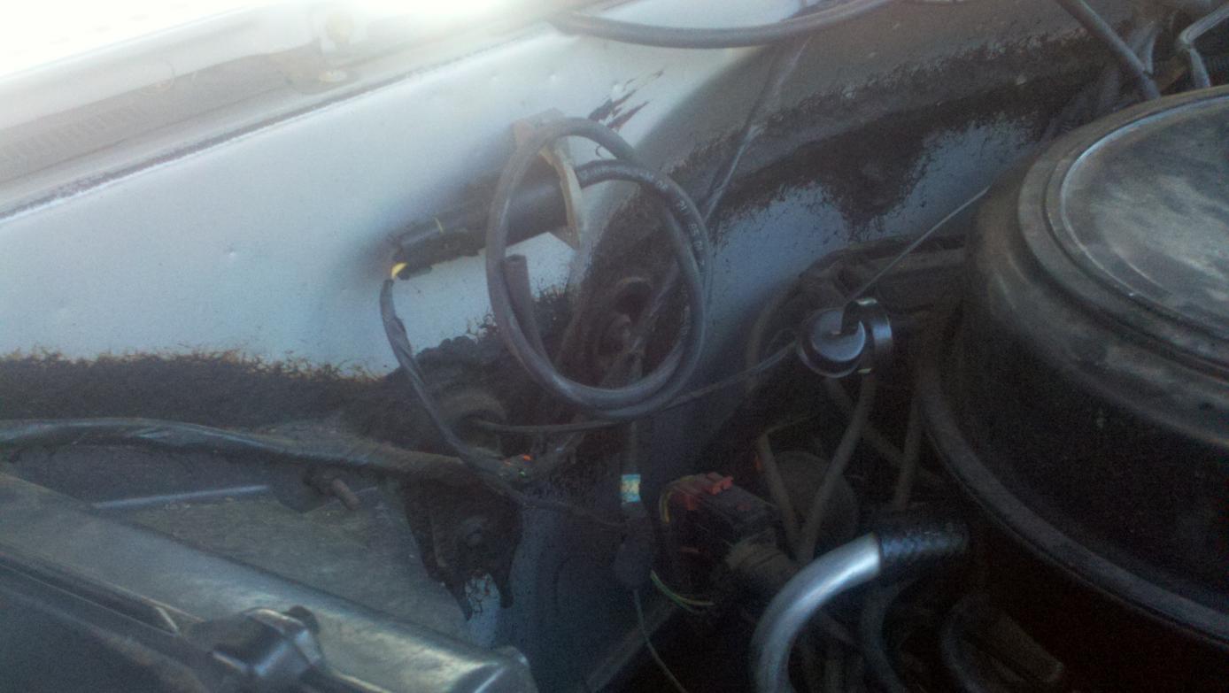

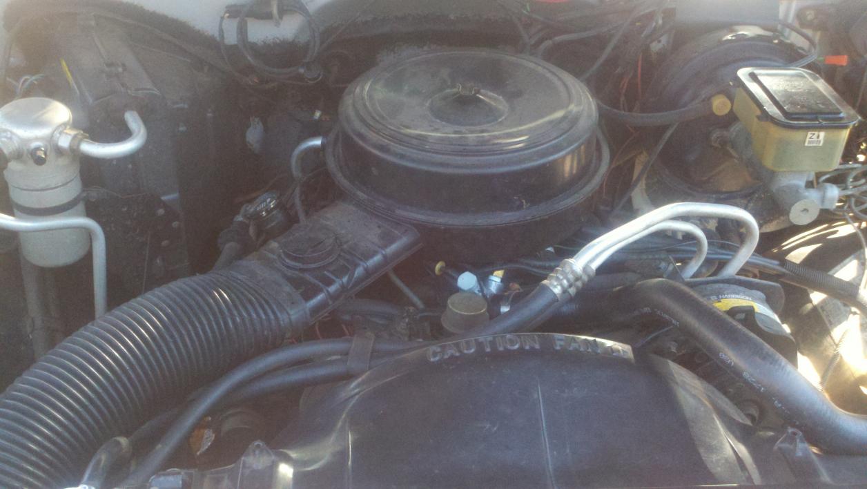

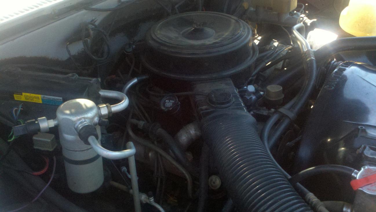

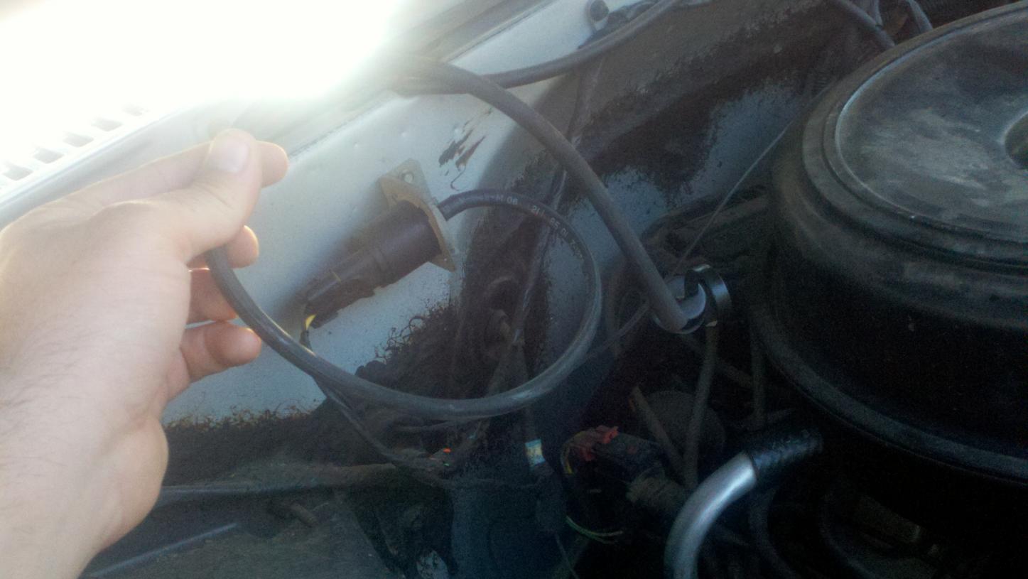

I recentley purchased an 85 K10 from its original owner. While looking under the hood i notices a switch on the firewall that has a hose on it. The hose is disconnected. I was wondering of someone could tell me what it is and maybe where it should be connected. Factory 305 motor. See Pics.

That's for the lock-up on the torque converter, the vacuum line should just go to straight manifold vacuum I believe.
