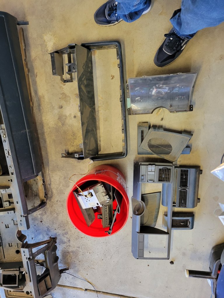

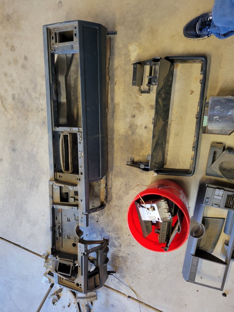

Thought I had posted this previously. Beginning the work of swapping my 90 'Burb dash for an early OBS dash. I think the donor for the mockup was a 91 pickup. Pretty well optioned at any rate, had digital hvac controls and the factory tape deck/EQ in the center of the dash.
What I want to eventually achieve, after figuring out if it'll even fit, is to have a One Gauge digital cluster and replace the factory radio (the one next to the cluster, rather than the middle of the dash) with some kind of infotainment/hvac unit. Have to figure out if there was an '07+ GM unit whose screen module will fit.
The truck will be getting a 6.0/6.2 and 4L80E starting at some point next year, hence the gauge upgrade.
I didn't get the heater box or any other underdash parts, ran out of time. I doubt the donor is going anywhere.
Stuff I know so far:
- OBS dash is 1-1/2" narrower than the squarebody dash: 63" vs 64.5" (planning on some kind of filler panel)
- The OBS dash attaches to the steering column. The Suburban has the same steering column so I'm confident it'll attach just fine, what I'm not sure of is the geometry - is the position of the column mount with respect to the windshield edge of the dash close enough on both trucks that it'll fit ok, or with there need to some fudging there too?
Will be reassembling the donor dash over the next few days, will add a photo then. Only thing I don't care for is the soft pad around the cluster module. I seem to remember my S-10s having just a rounded hard plastic edge on the cluster section - Did the early OBS have some variation in edge treatments?
