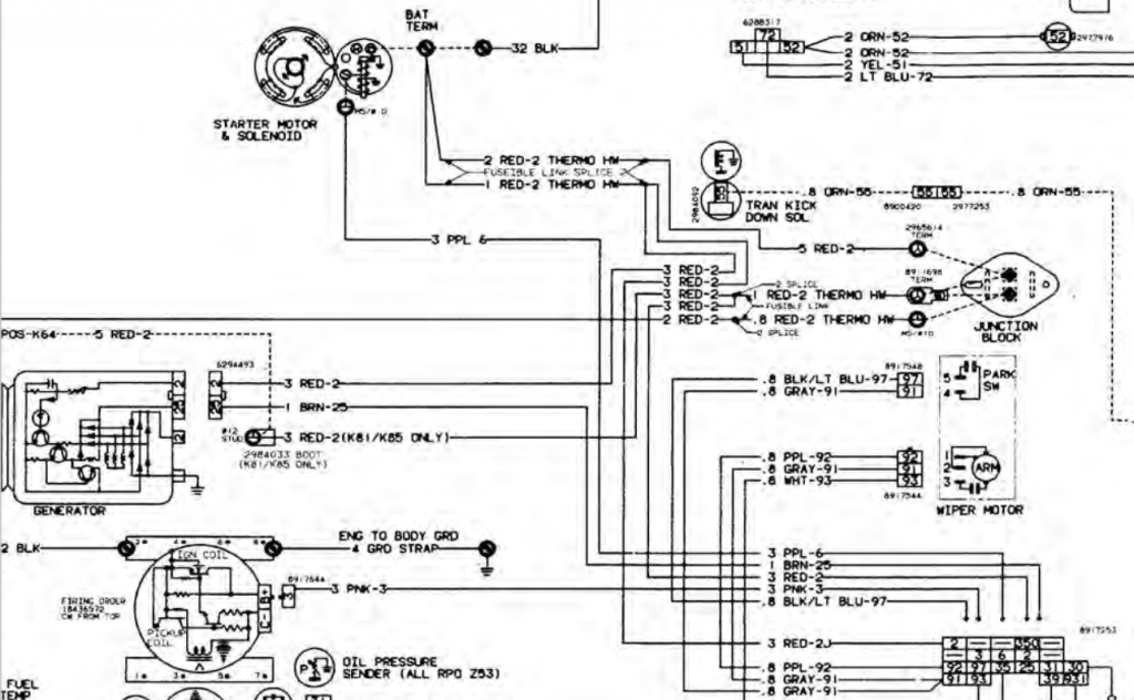

I am trying to find the best way to wire my alt but i for got where any of the wires go i guess i taped them long ago ,truck sat.forma.while an now i am tryin to figure out what the 2 red wires that i cut off.from the starter go to ,I ran the one wire to starter from bat, but now.i have no power to any thing there.was one red wire that i left hooked.up to the small connection on solinoide, i just tryin to.clean.up the wires by maybe eliminateing some that i problly need, lol since i am here I also have.my electris fans maybe.2 is to many ,should i down size.an the electric fuel pump ,an the electric watet pump i have them all routeing to one.wire to the batt from a toggle switch from each one, i know as soon as click the fan on an go to click the other switches to on u can hear the fan go down in power reduced i know this is a.lonf question an might have to broke down into several questions but who else would understand.me. but square bodies lol

Starter wiring is easy. Someone will come along with a link to wiring diagrams or you can search this site. They are here.

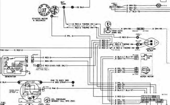

Now put all the wires back at the starter like you found them,2 of them were fusible links that provide all the power to the fuse box. Running all electrical loads to one source with a toggle switch is also a poor choice. As to wiring the alternator B+ goes to battery, terminal 1 goes to the the brown wire,that is the exciter wire,terminal 2 is voltage sensing wire which should go to the terminal block on the firewall,you could run it to battery + post it would be functional,but not as functional as factory. This is all from memory I will be double checking a couple of things,so check back later in case I need to edit. Okay,double checked,alternator wiring is correct.
5,917
9,931
Sorry electric fuel pump get a 4 prong relay from the parts store hook terminal 30 to battery + hook 87 to fuel pump. Hook terminal 85 to alternator exciter,hook 86 to ground. Now fuel pump will only run with the engine running. Same set up for fans but use a relay with a built in capacitor and hook 85 to a thermo switch.
