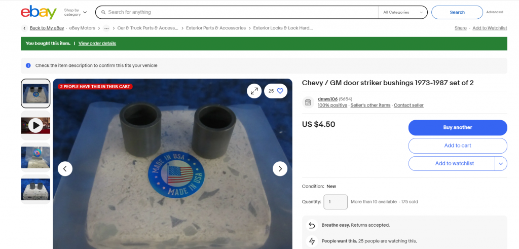

bought these off ebay in July and work great
