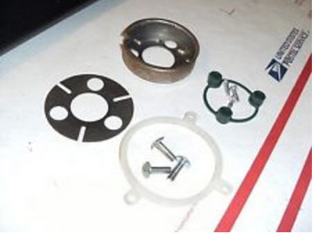

Stock wheel in my '84 K10 Custom Deluxe. Looks like this one: http://www.ebay.com/itm/1973-77-Che...ash=item25abce0444:g:5IUAAOSwPcVV0MFS&vxp=mtr
It doesn't look like I have and switch or anything under the center cap and it doesn't move if you press or pull it, but there's a horn behind the grill. How can I verify if mine has the proper workings or not? And if it doesn't, can I convert it or do I have to buy a new wheel?

Yes, that is a correct wheel for a horn. you should have some parts like the ones in the pic as well as a piece that reaches up through the wheel. Watch up to 3:00 in this video to get an idea of whats all supposed to be there.
https://www.youtube.com/watch?v=Sp5lURpXviM

This is what I see when I pull off my center cap. That cup doesn't move at all, not sure if it's supposed to.
This is my cap. No metal parts or connections on it.
30,353
28,044
Yeah, that cup is supposed to move. It's either assembled wrong or something is broken or rusted.
Given the track record this truck has so far, I wouldn't be surprised if it's all 3.
