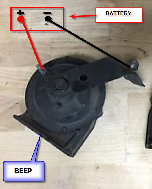

The test light is probably acting as a resistor, I would try a plain wire lead. They may work just fine.
Georgeb
Apr 30, 2015
3,259
214
Wisconsin
George
2003
K10 Burb Z71
Like this.
