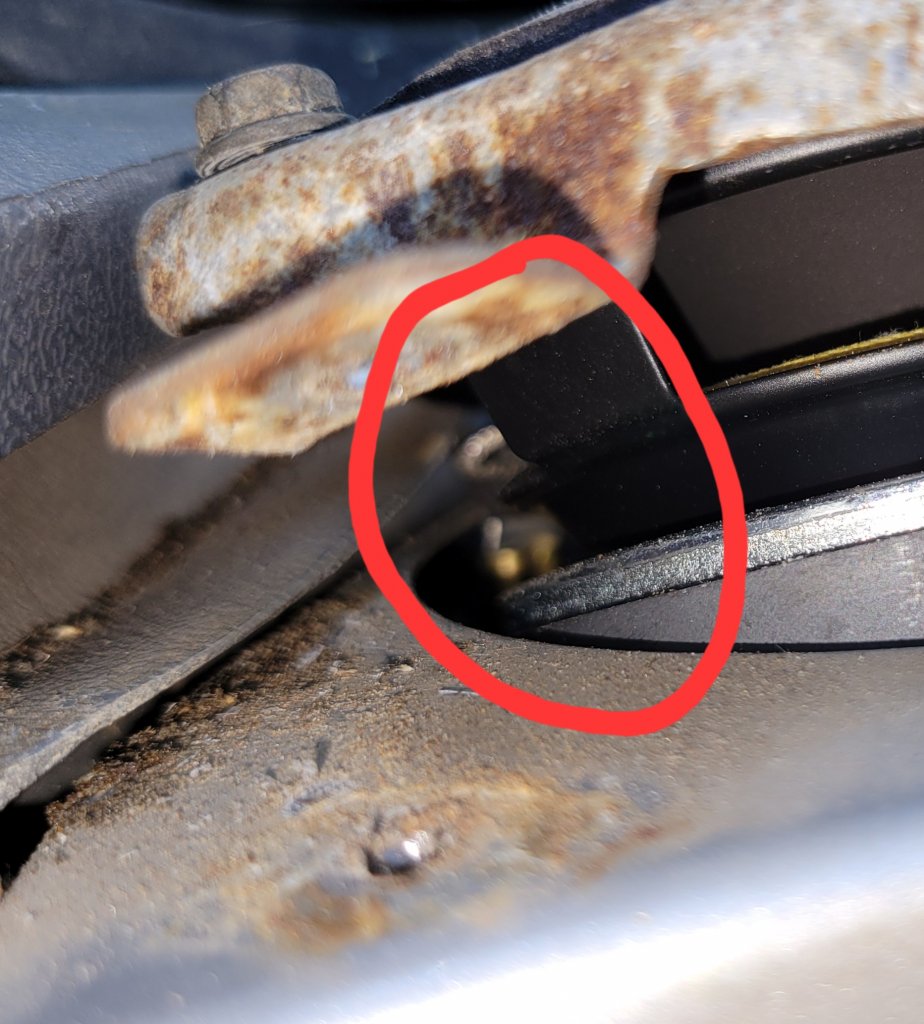

Messed around with this a bit more this morning after taking a picture of the problem (attached). I was able to bend the tabs on the speaker more towards the magnet and rotate it so it faces the gauge cluster. Just enough clearance and now it's not resting on the sheet metal and A-pillar trim. These speakers sound bad enough without adding buzzing and rattling to the mix!
One day I'll do a 3-way setup or something like that but for now this gets the Bluetooth radio functional. Now to clean up the dashpad a bit.
Thanks everyone for the suggestions!

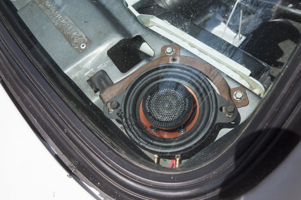

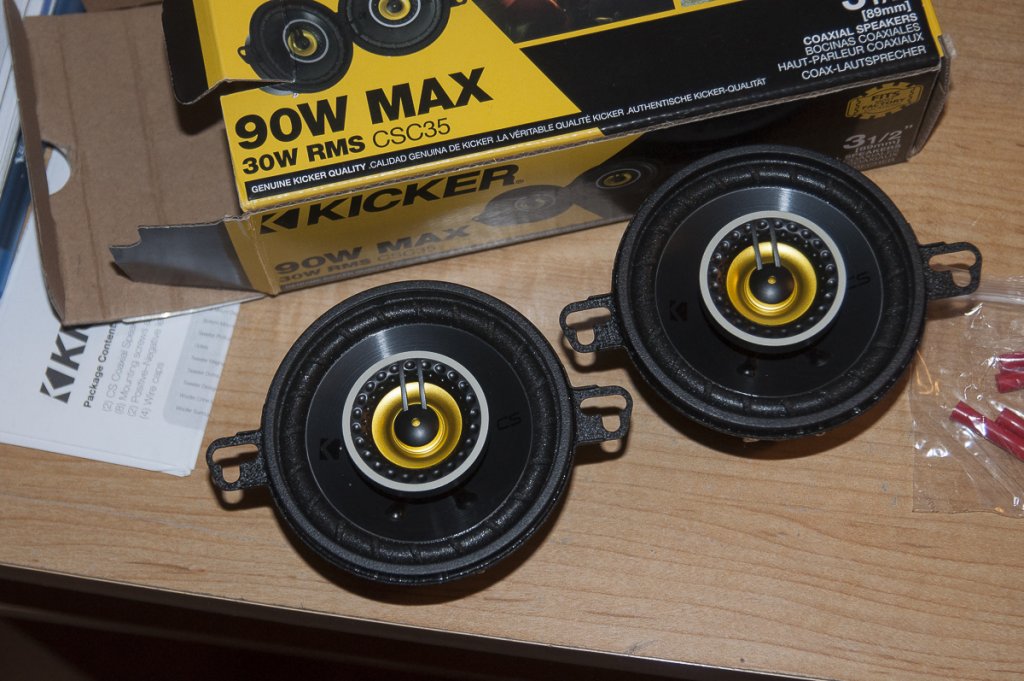

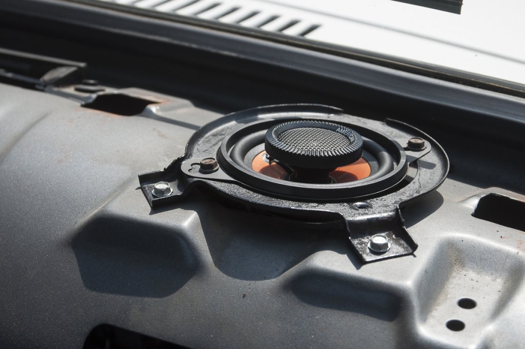

i install a lot of those in the past and present (ex worker at auto radio store) and never add a issue even today modern 3.5 fit great and sound amazing ;)
