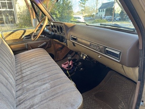

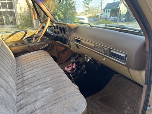

This is what you'll need to do if you want to use that metal frame and throw a cap or upholstery over it. Otherwise you'd be money and time ahead to just buy a replacement dash pad assembly like we sell.
