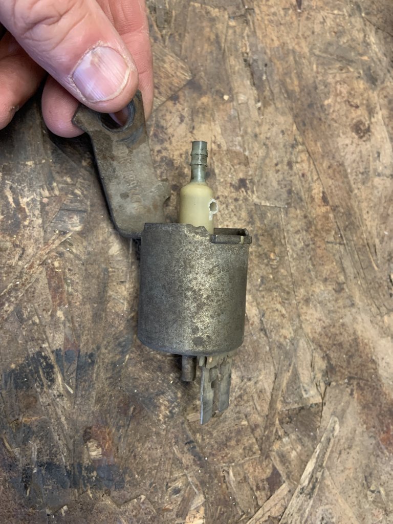

Can somebody identify this part and tell me how the vacuum lines are supposed to be routed?
I was changing out the thermostat and one of the vacuum barbs broke off.
It was attached to the thermostat housing, 1983 K20 350CID.

Doubtful. Truck doesn’t have cruise control. Looks like some dumb emissions nonsense. I bypassed it and the truck seems to be running fine without it.

IIRC, it stops vacuum from reaching the dizzy can until the engine is at operating temp.
