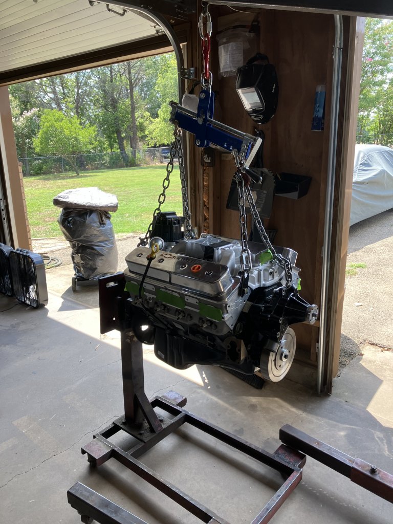

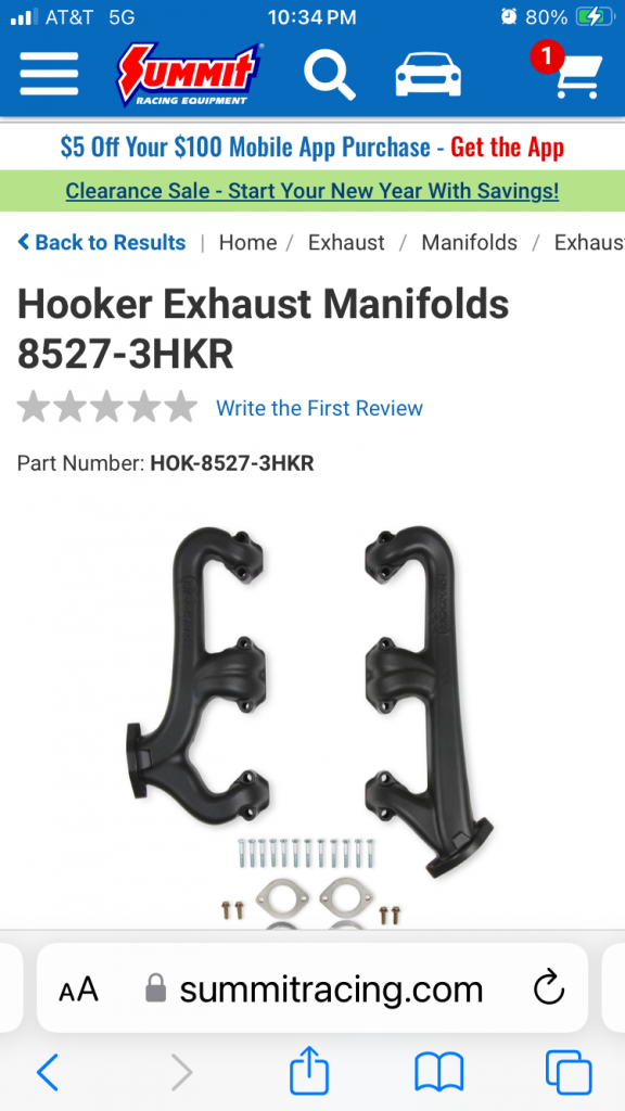

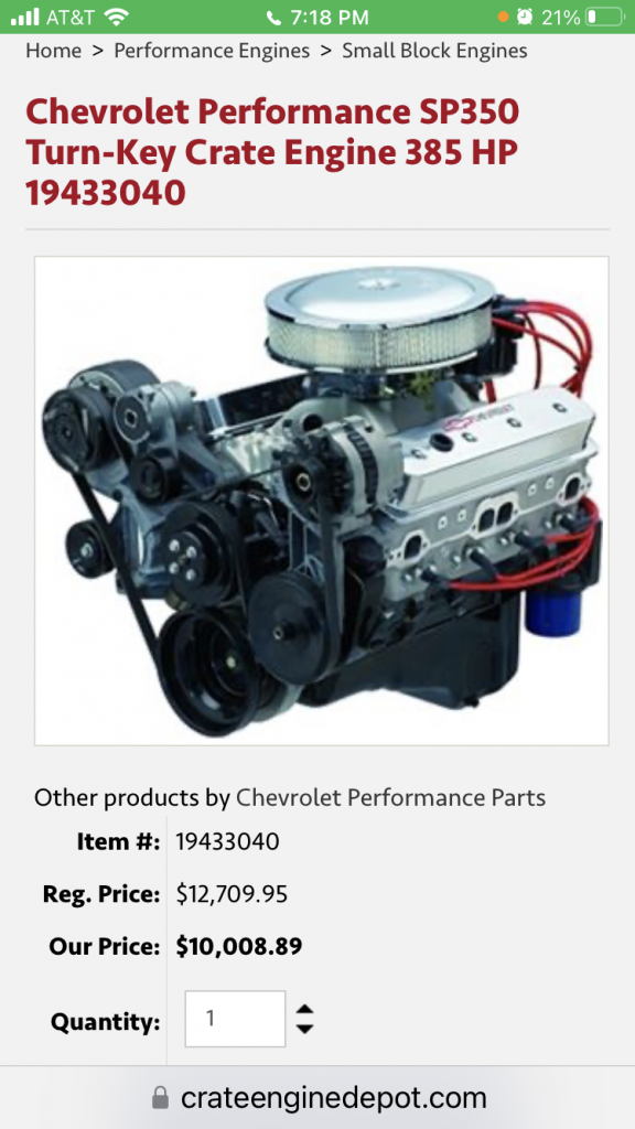

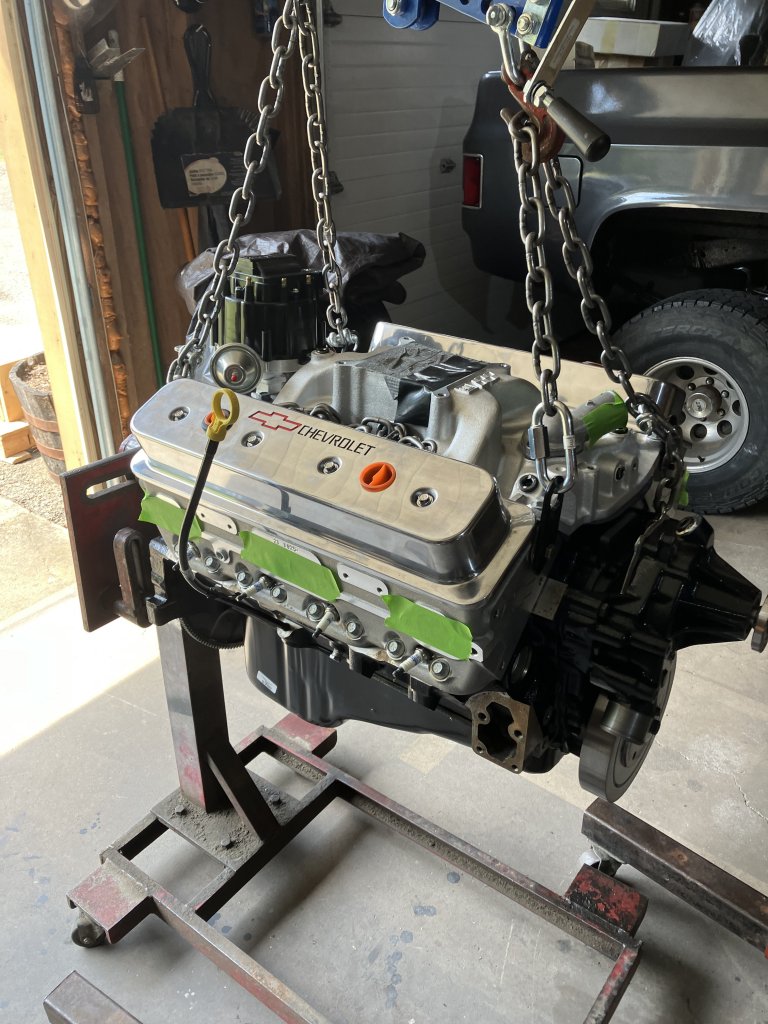

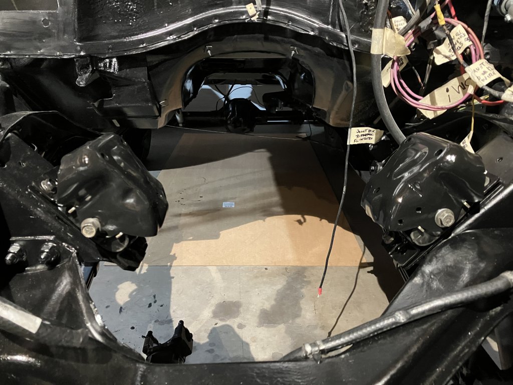

I’m prepping to install a new complete turn key GM crate SP350 (385HP/405TQ) engine into my ‘83 K5 that I have (almost) finished with the multi-year restoration on and would like to get y’all’s final recommendations on the engine install plan/idea before I get started. Things to note: I am doing the work by myself but can get help, if needed but it may not be right away that any help would be here to help me. So, I’ll need to take the fastest, easiest and safest approach. I have a hoist, transmission jack, lift jack, an engine hoist, engine leveler/chains, an engine stand and an engine lift bracket that mounts to the intake manifold. I’m working in my very hot garage and will have to have the Blazer front end just inside the garage and the eng/trans/hoist inside the garage for smooth concrete to roll the hoist forward. I removed the entire radiator core support for more direct installation (the fenders and wheel wheels are still in place). All the new engine accessories, pulleys, carb, brackets, starter, etc. have not been installed. My initial thought is to mate the core engine to the completely rebuilt 700R4 and install the combo first using just the hoist and the manifold lift bracket since I can go almost straight into the engine compartment. Doing it this way will eliminate the additional weight making it easier for me to man-handle the eng/trans and hoist
and will eliminate all the accessories from getting caught on things. Then I would install the accessories from the open front end and the starter from underneath since I have plenty of headroom under the 4” suspension lift. Now for my questions. Is this the best approach considering my situation and limitations? I don’t yet have the new trans lines but should I buy/install them onto the trans before installing the eng/trans combo? Trans dipstick: install before or after eng/trans combo install? I am considering exhaust manifolds over headers. Should I install them before or after engine install? What else should I do before I get started? Any other recommendations? I provided a picture of the complete turn key SP350 engine but again, I have not yet installed the front accessories. Only the distributor is installed. Another reason for using the manifold lift bracket instead of the leveler and chains is to eliminate the need to remove the distributor and also since I’ll be able to go almost straight in with the eng/trans I don’t risk damaging the distributor. Thank you, so much, for your guidance, once again!!!
