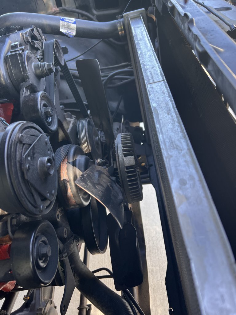

Hi everyone thank you all for the help so far.
83 k5 with 454
PO did some things good and others no so good.
I got this truck from AL and I’m in FL. Buddy of mine drove it down.
Lost the radiator on the way and replaced with whatever they had in stock at 8:45 at night in middle of nowhere outside Valdosta.
So the radiator mostly fits. Is about the right size and is AL. It’s about 2” too short and o can probably find something to make the brackets work OR I can get the right one.
The other issue I have is the shroud does not fit the “new” radiator AND I only have the top half of it.
The he engine swap I think puts the fan slightly lower than original and that’s why the PO removed the bottom half

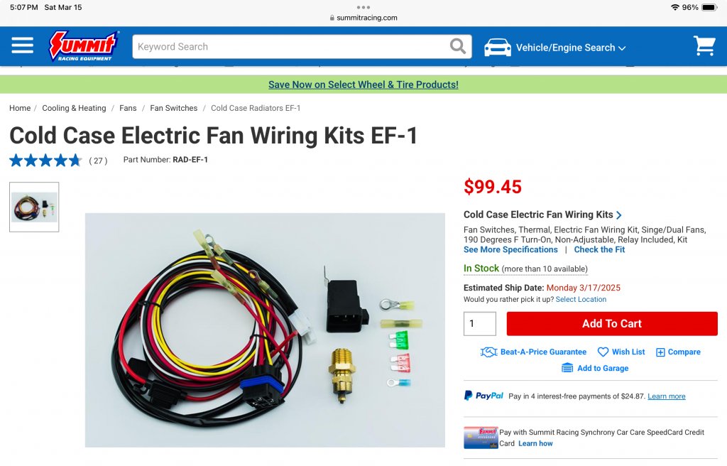

SO I’m thinking about electric fan/shroud combo to go on either the existing ( 2 inch shorter) radiator or a new correct one.
Any suggestions on brand/ set up? I’m thinking duel fans with thermostat switch’s?
Truck has AC that is not working but is there and plans to fix that once I get this figured out.
I’m in FL and it’s hot here most of the time
Appreciate help and guidance Thank you !

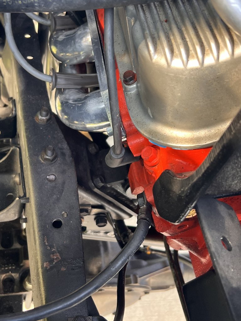

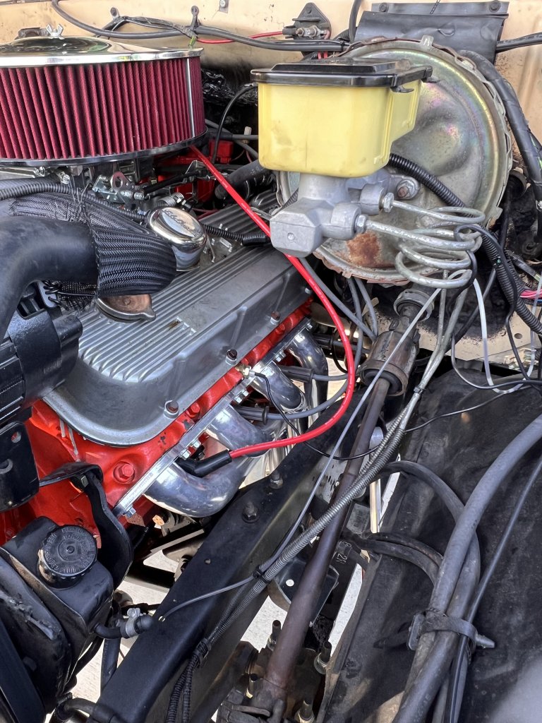

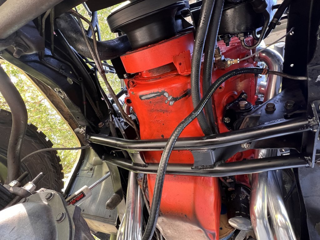

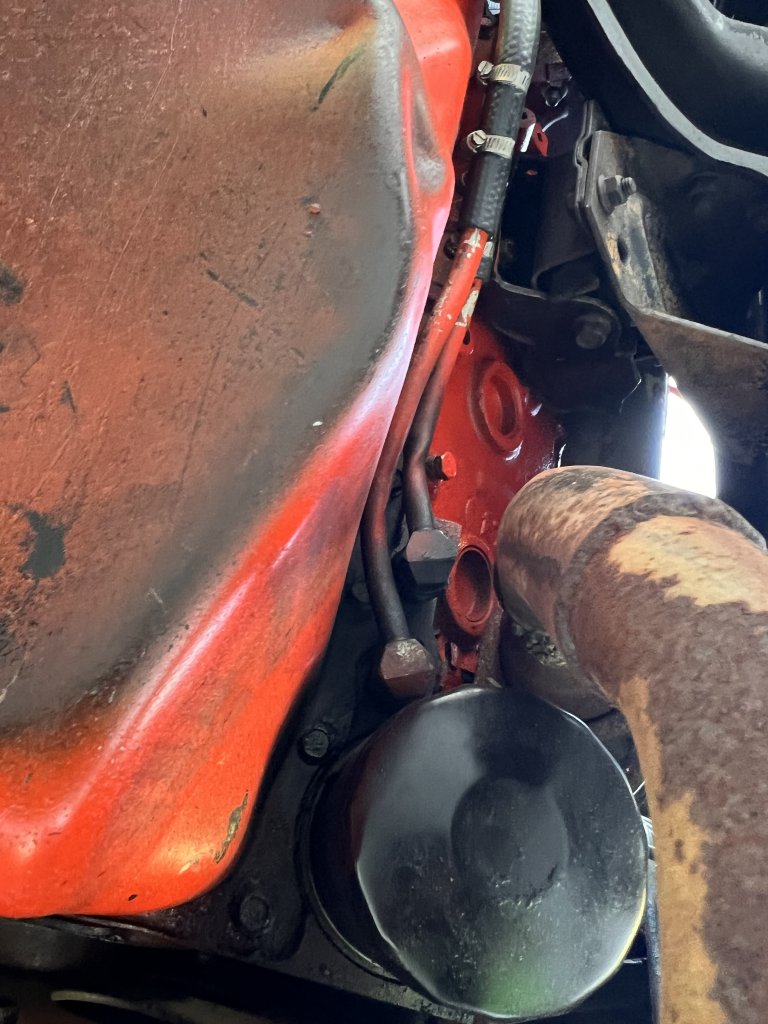

My block is early 90s I think, and has oil lines coming off the block. Right now they goto a $20 tranny cooler.
I think I found a spectra radiator that has oil and tranny cooler in it. That would do me pretty well I think.
I don’t know much else about the motor other than it’s got old M/t valve coverage performer intake and a 600 holly. I just put on headers and magnaflows and the truck feels more powerful and sounds amazing quiet at idle and nasty if I get on it.
I have a new 750 holly to put on and then see where I’m at.
Need to get the cooling figured out before FL summer comes back in 2weeks

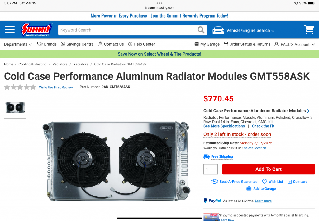

I installed this Cold Case radiator in my 75 454 Blazer. Installed with no problems and works great so far.
