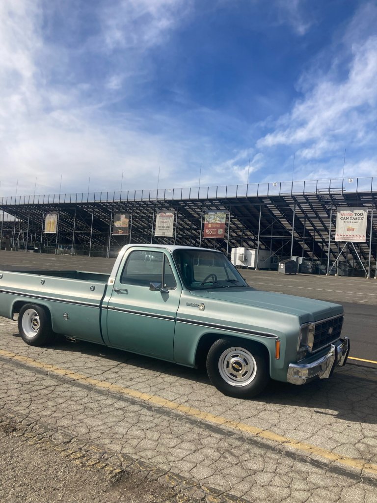

I used the spacers to raise it a bit after installing 2.5" drop spindles with 2" lowering springs. Aftermarket springs were weak, front was a bit too low. Spacers worked great.
