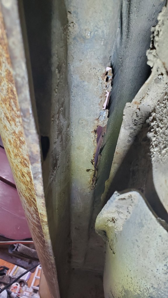

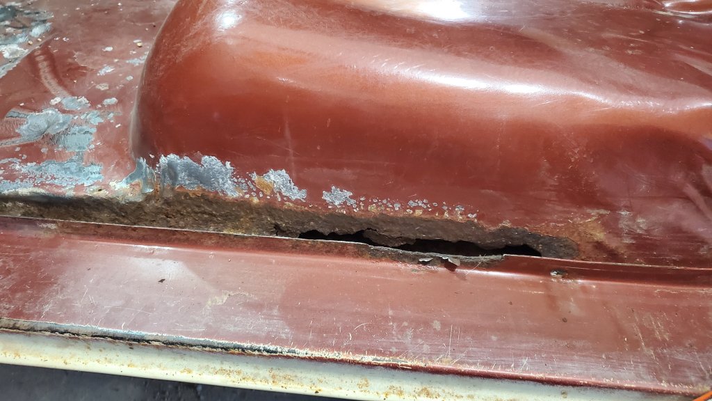

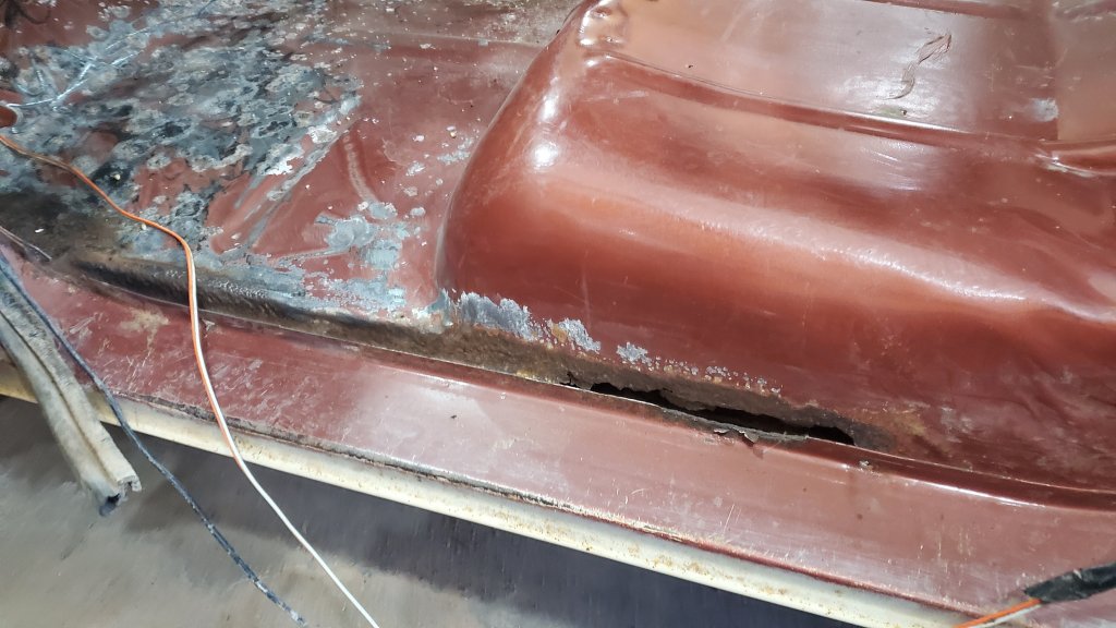

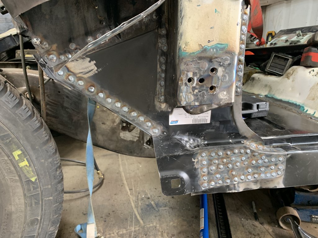

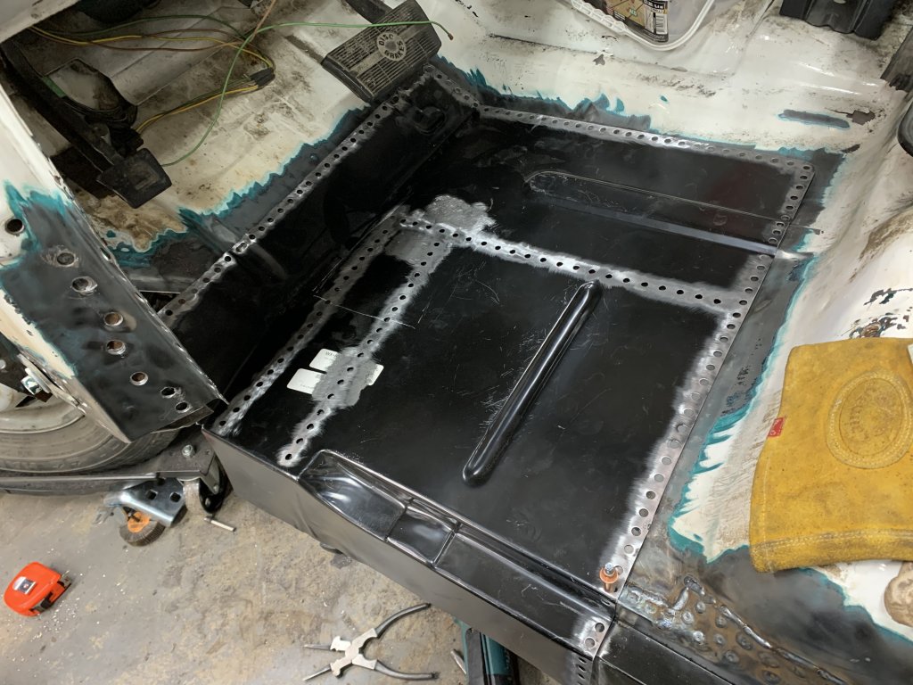

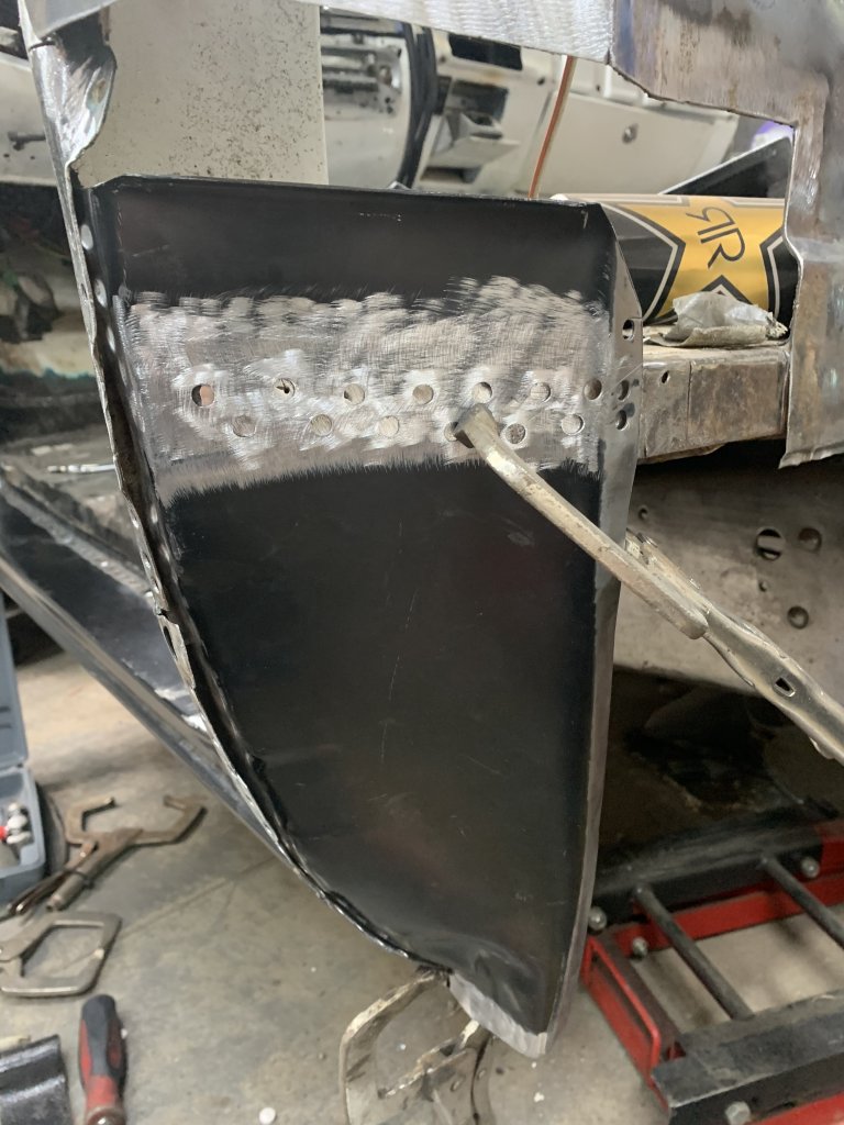

I found some rust while doing the teardown on my 82 that i wasnt expecting. Its about 7 inches long right at the bottom of the seat hump on the drivers side. I'm planning on doing the repair myself but i'm a little unsure which patch panels i need to order to do the repair. When i look at the catalogs from LMC, Brothers, etc i'm pretty sure i need the inner and outer cab rockers but the parts in the catalog never quite look right.
Unless theres an easier way to deal with this rust? Cut it out and patch it from underneath with just sheetmetal? I'm a newbie when it comes to actual bodywork, but i'm a pretty competent welder and have a Mig, Arc, and Plasma cutter to use.
Any help would be great.

I think I'd cut out the rusted area and just fab up a new patch. it's a pretty straight forward patch as far as shape and size goes.

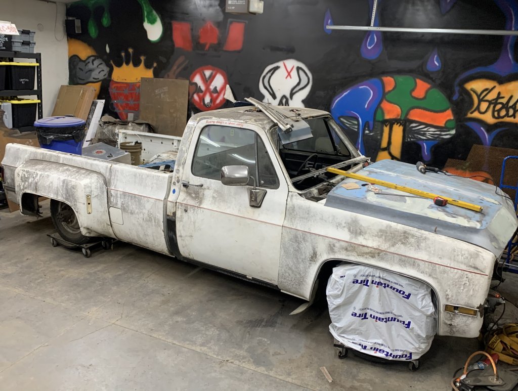

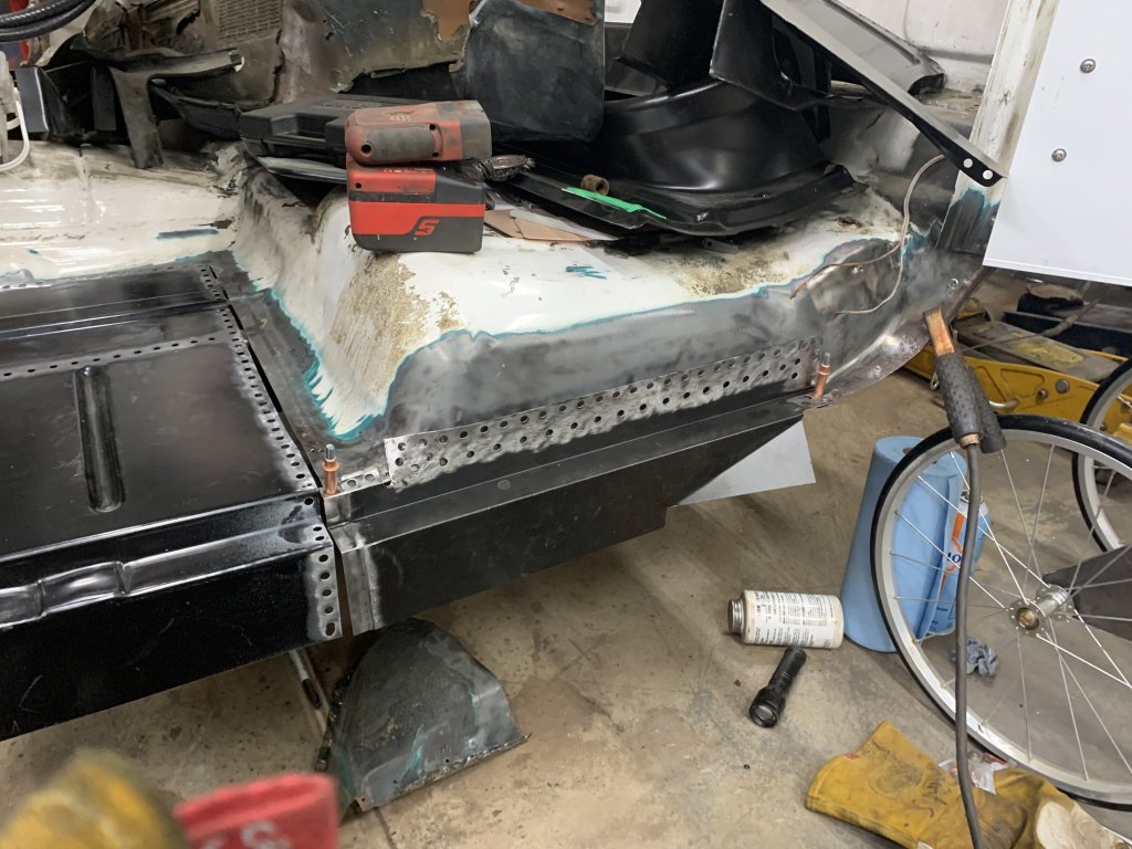

It does…

Thanks, those pics are actually quite helpful. I must have watched a few hours of YouTube videos on patching squarebody panels and still couldn’t get a nice clear pic of what I want to do. I was a little hesitant to just start cutting away.
