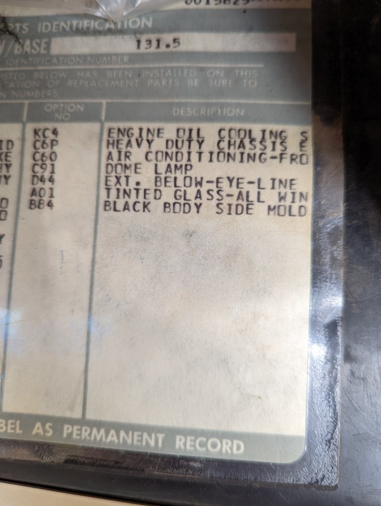

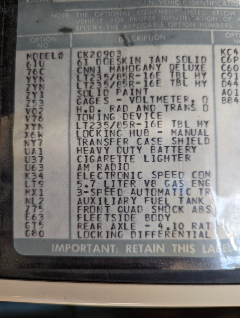

The plot thickens...
I bought this truck through a guys Dad who was handling it. His son was deployed. He called it a K30. I just checked the sticker in the glove box. Picture below. After some googling, I think I have a K20, and not a K30. C6P code though...
I looked up the K20 brake booster, and it looks like the one I have. I wouldn't mind converting to hydro boost, but I'm guessing I'd have to swap out my steering box to do it. I can only see 2 lines on my steering box. Could be wrong, I haven't researched it enough to know what all is involved with the swap.

You are correct; model code CK20903 =
C = Chevrolet nameplate
K = 4x4
209 = long wheel base 3/4 ton
03 = pickup
K
4,187
8,004
I have the same truck. I converted from vacuum to hydroboost. Not a big deal. I have often wondered what the C6P "heavy duty chassis" actually means? Keith?
