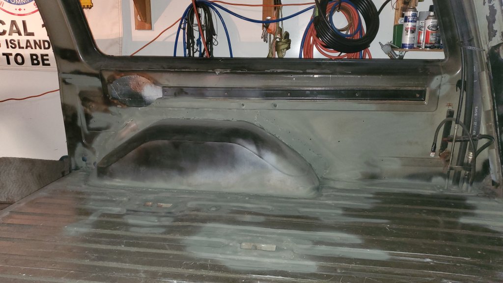

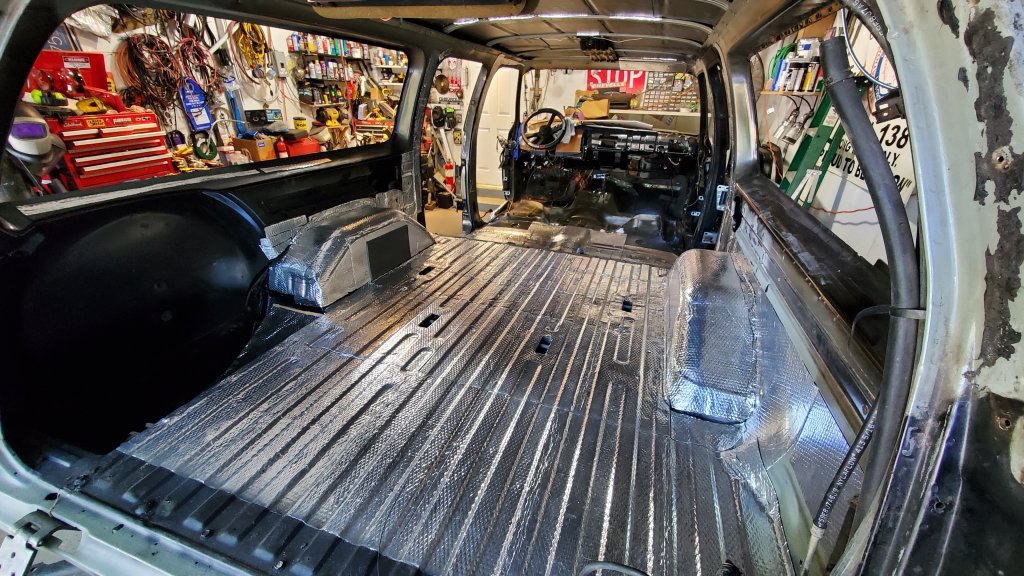

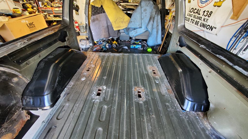

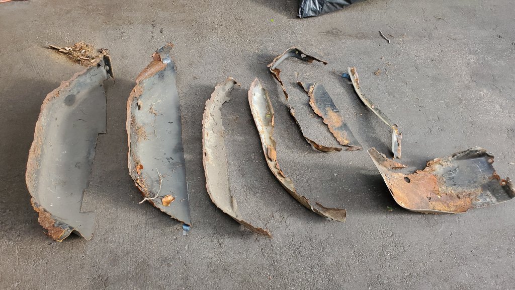

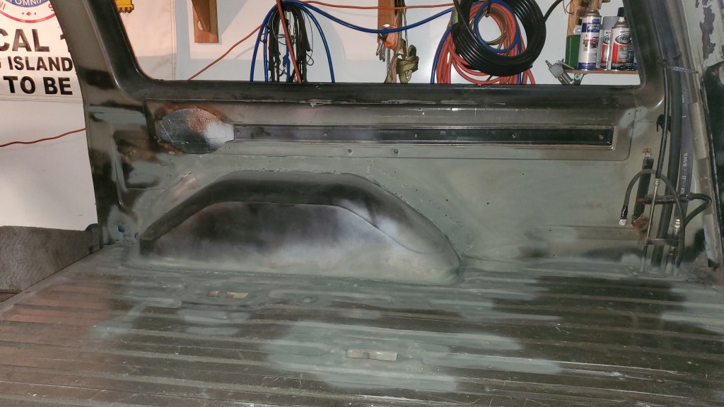

I bought my metal parts from a company called goodmark.
I had to use pickup rear wheelhouse's for my 90 suburban

Only part i couldn't find are the rear wheelhouse's. I used inner and outer wheelhouse's for the pickup

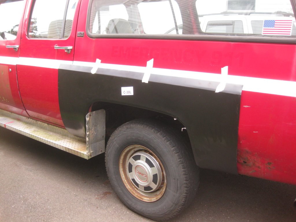

Hi,

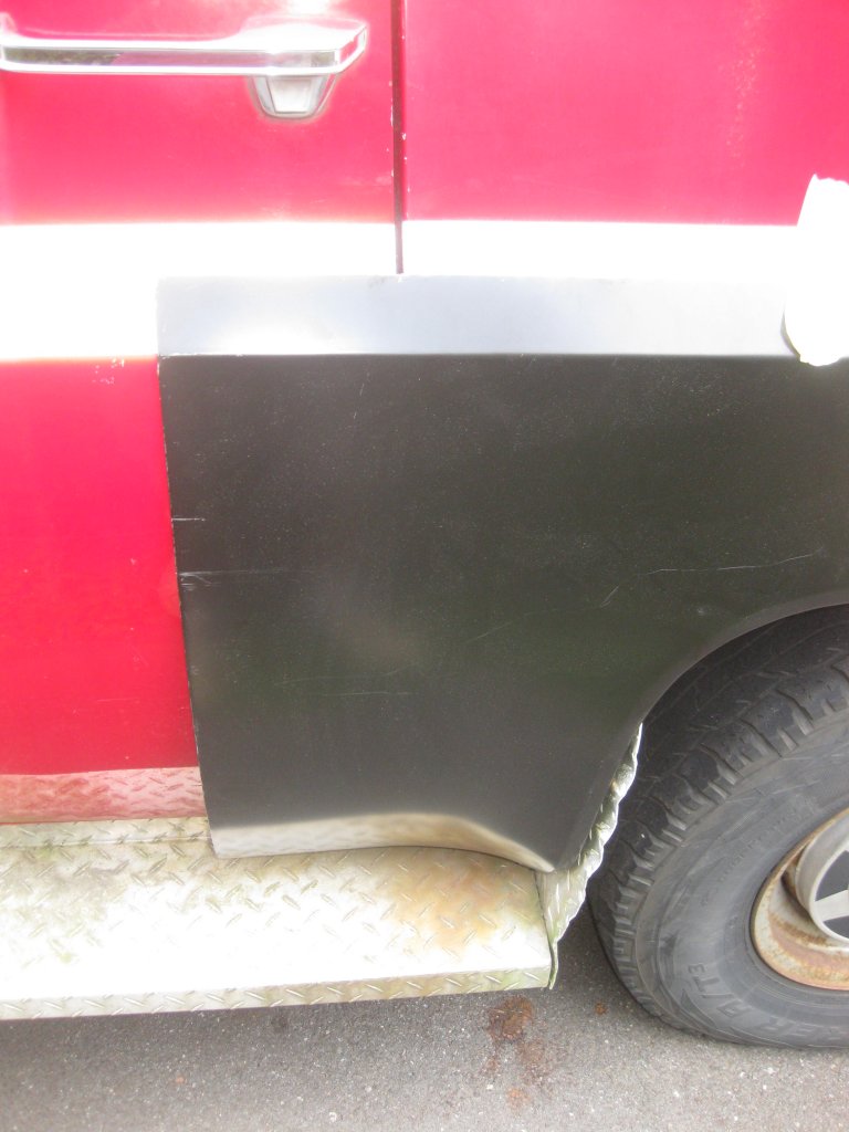

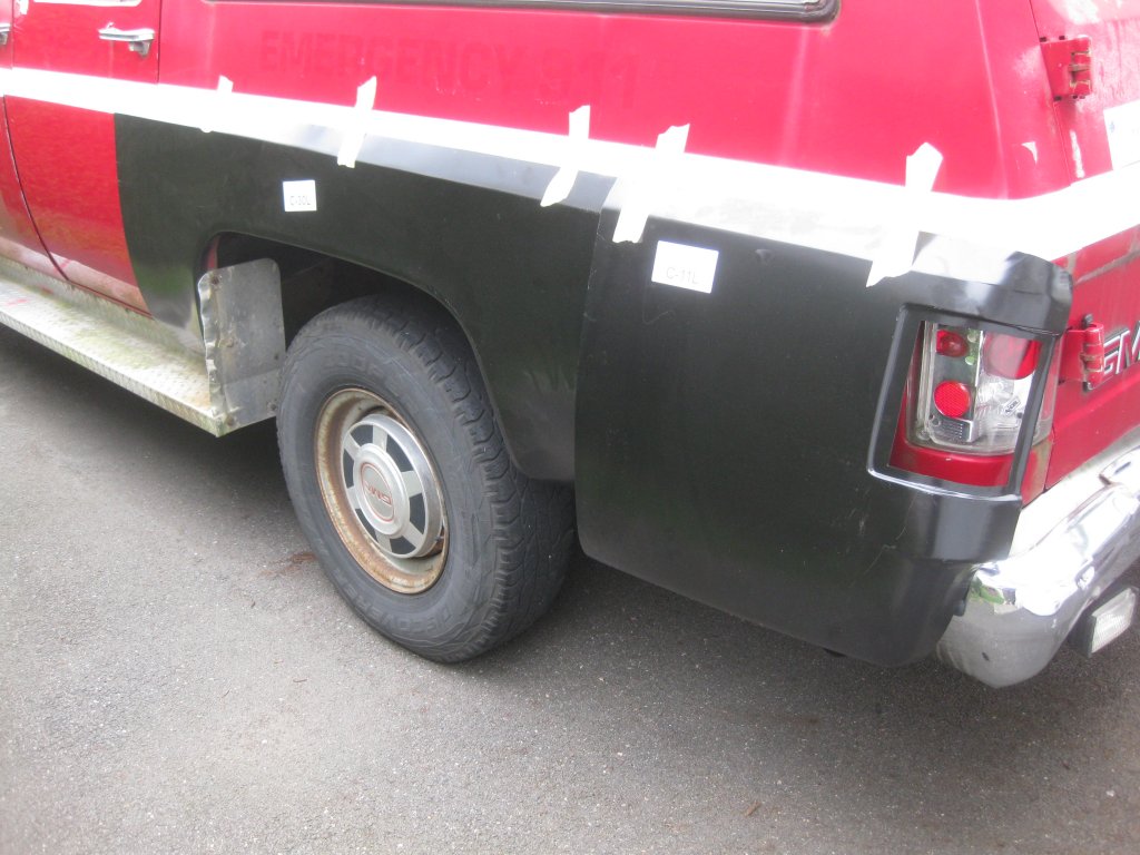

I went through looking for rear panels for my 1990 V2500 GC Suburban 3/4T, 6.2L diesel. I found a few suppliers of the body panels. One was geekparts.com. The problem with the panels is shipping. Currently the panels from them cost $47.98. The kicker is that it cost $150.79 shipping and handling. They do have a note to inspect the part for damages if damaged refuse the item. They will refund the shipping charges and part price.

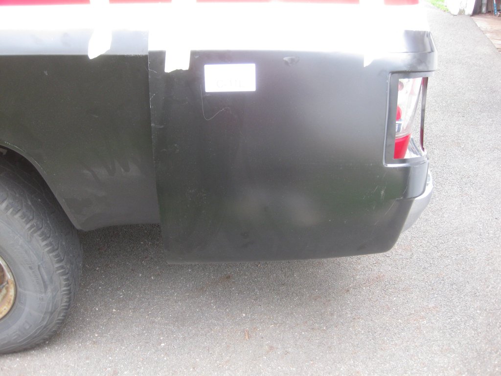

I found a supplier of body parts in Connecticut 1 1/2 hrs from me. Auto Body Specialties a small family run business. They had the LR panel for a pickup in stock. Their ad for the panel for a pickup says “Fits: 1973-91 Suburban (trim at rear door).
I went there and they let me take the panel outside to see how it would fit. I was able to overlay the panel on my suburban and it fit except that the length was past the rear door opening. As they said it has to be cut to fit.
This is the webpage for geekparts.com
https://www.partsgeek.com/catalog/1990/gmc/r1500_suburban/body_mechanical_-ar-_trim/wheel_arch.html?brand=action_crash
This is the webpage for autobodyspecial.com
https://autobodyspecialt.com/lh-1973-1991-chevy-gmc-truck-rear-quarter-extended-wheel-arch/
I have attached a photos of the panel I bought at ABS taped over my rear panel and the rear tail light panel.
I spent many hours looking at various suppliers of body parts these are the two that I found to be better in price and availability.

Whoa thanks for that info!!! So the rear panel for the pick up matches the burb?!? Mostly the wheel arch concerned me. If so that opens up lots of options for me. Thanks for the links!

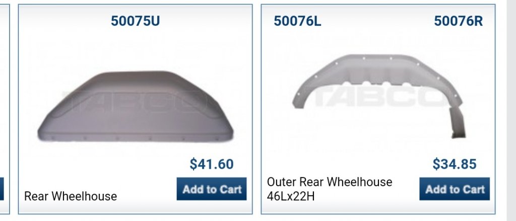

For those of you that have replaced the inner wheel house, did you find that both of these parts are required? Even if using the truck wheel tub?
Thanks!
