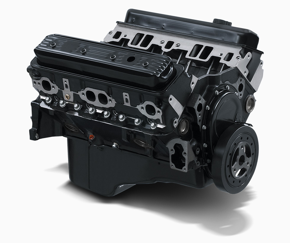

Probably just a generic pic they chose, but the second pic in the gmperformance link you posted, shows a pic of the (sawtooth head) vortec engine. Weird.
Maknwine
Nov 24, 2016
101
141
Virginia
Tom
c30
Haven't seen a tbi on a pre-vortec (12 bolt intake). Are you sure it isn't the later vortec (8 bolt intake) engine you want?
I did not even notice the difference in heads from the 1st pic to the 2nd pic on the GM link....you got a great eye.
I'm not as educated about the differences in the 350's to say for sure but my IM has 12 bolt holes. Looking at the first pic, I think I can count 6 holes on the driver sd head for the IM.
