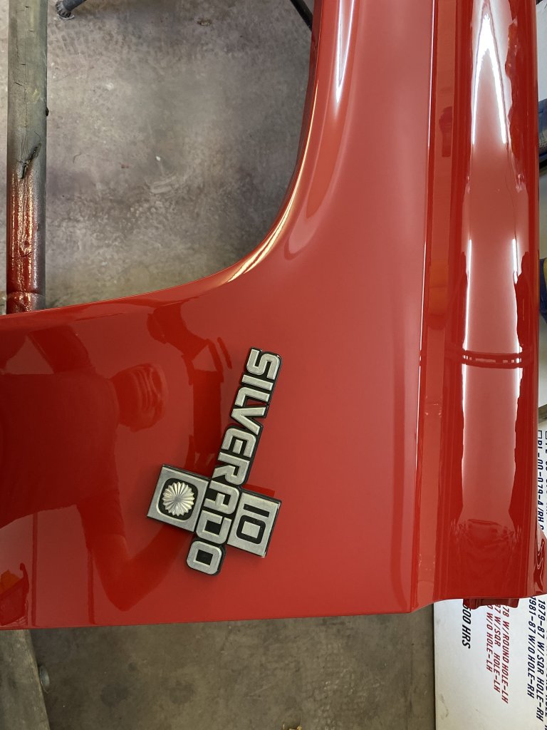

Need to know where to drill the holes for the badges. Threw the old fenders out without realizing the new ones didn’t have the holes

Never mind, I spotted the access holes to the nuts on the backside and drilled one hole and squared it up from there

Suggestion, use barrel nuts so you don't have to access from behind if they need to be removed. Lots of work to remove a fender for a badge.
