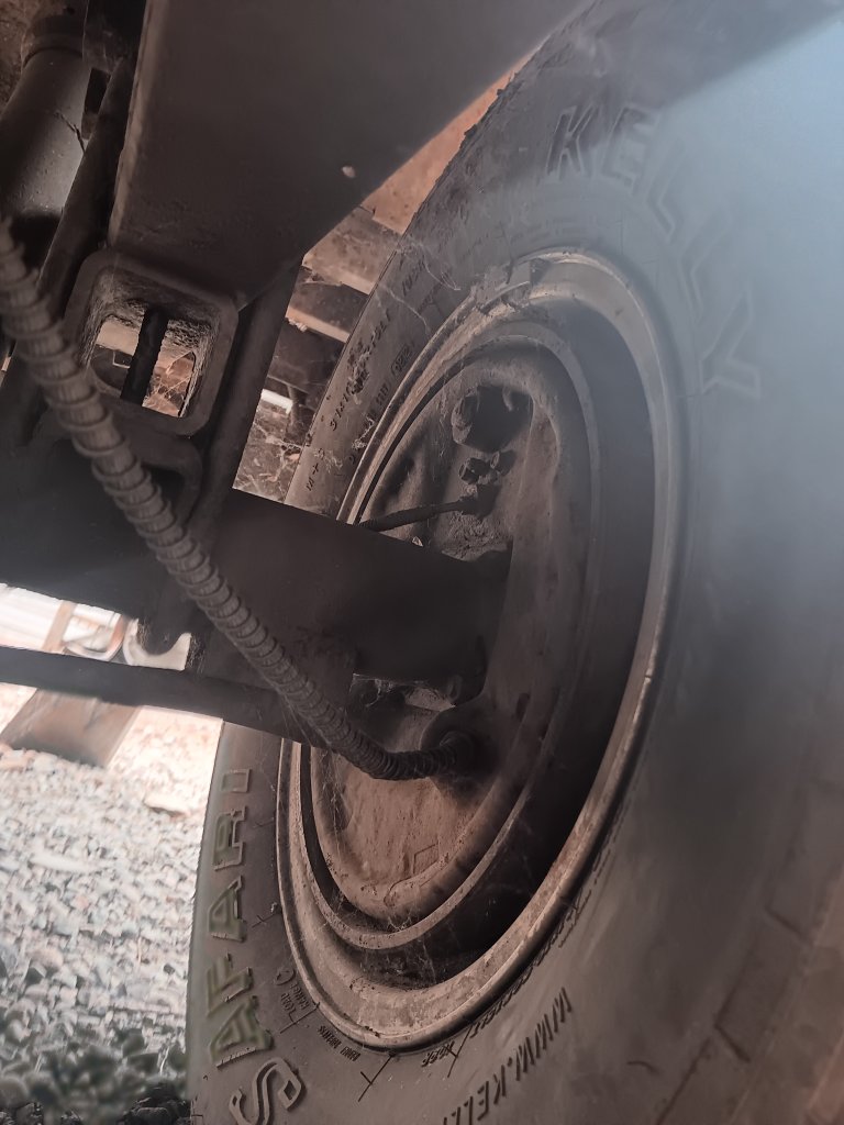

this is the backing plate with the old style cables that came with it, I’m hoping that the parking brake kit for the 84’-87’ squarebody is a bolt on deal.

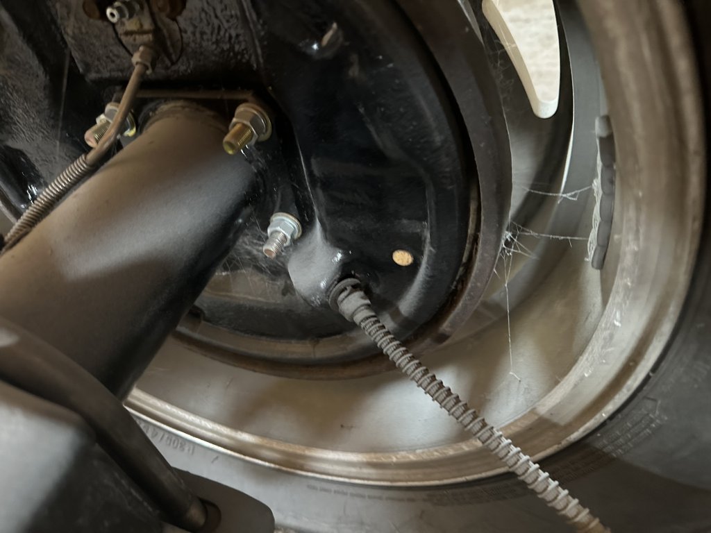

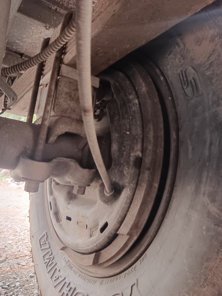

First picture left is a 1980 K10
Second is my 91 3500 square 3+3

Thank you Squaredeal, from the pics I think the backing plates are very similar across the years. Though the pic of the 91’ is a 3500 I think it says that parking cables were routed in a similar fashion regardless of size or rear end.
