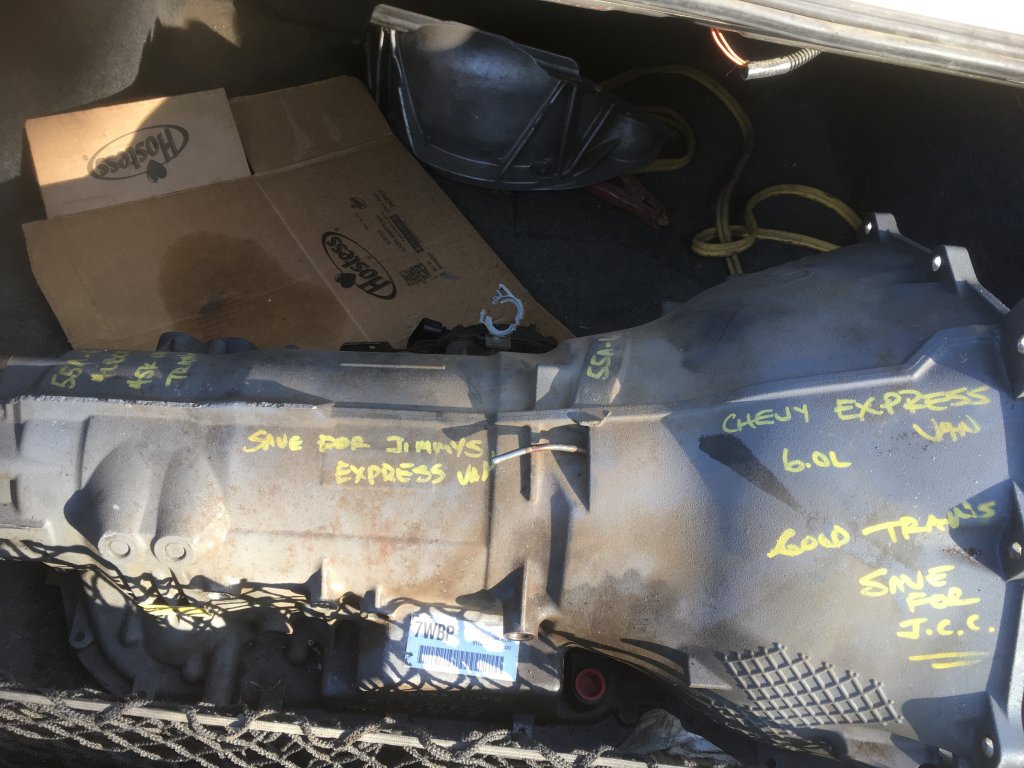

I have a few 4l80e, and retrofitted it to my 454 with an adapter from Advanced Adapters. Mine was a two wheel drive trans so I can run my speedo from the trans instead of the 205 (73) which does not have any of that stuff. tale shaft comes off and the AD goes on. Also the adapter comes with the input shaft with the big bearing for the205, which must be machined for the bigger bearing. I could get pic, stuff is up in the shop.

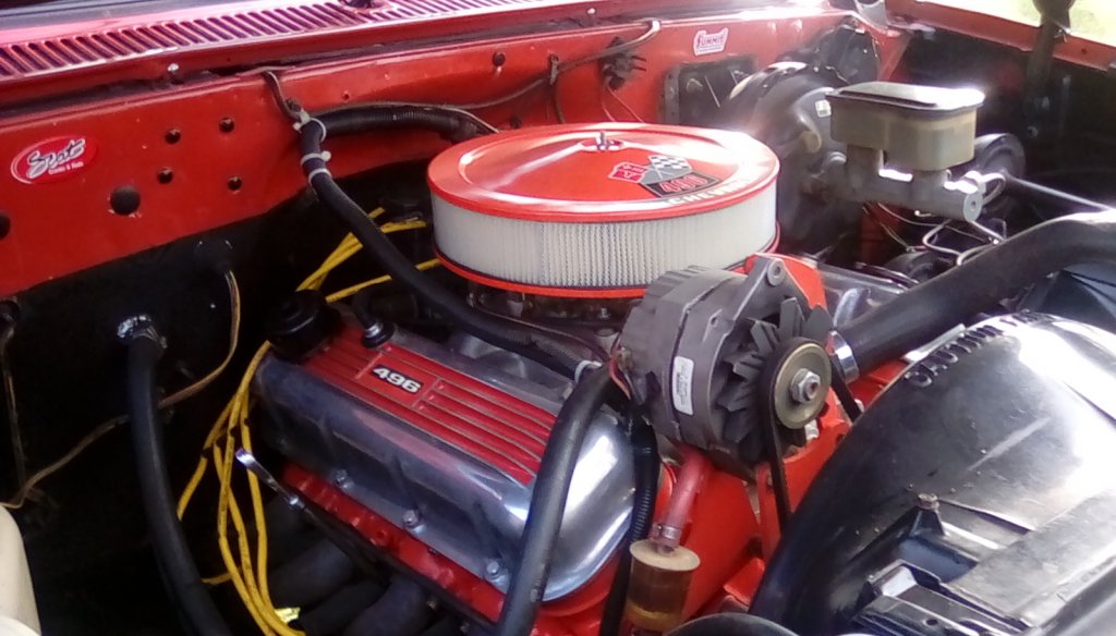

I like those valve covers. I'm getting lazy in my old age, like the automatic unless it's a just for fun car.
