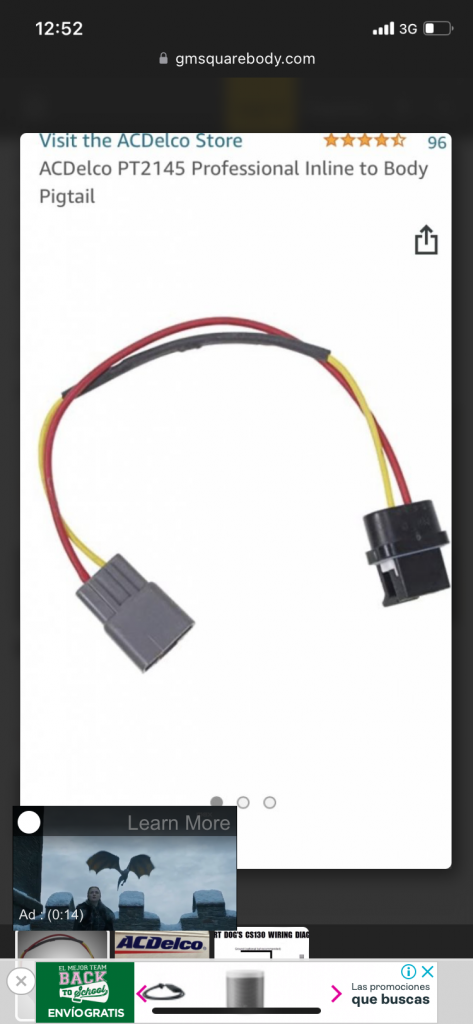

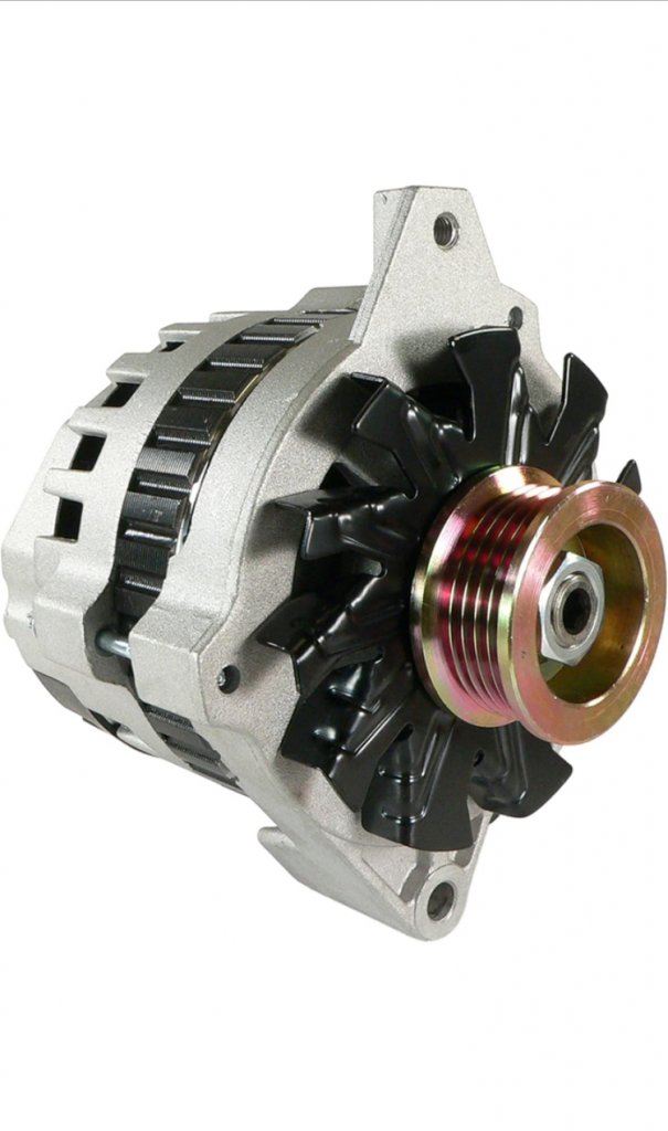

Hello friend, I hope you are well. I am installing an alternator on my Chevrolet 350. In this case, I chose a 180 amp alternator. The original one is 78 amp. I changed it because I installed electric fans. Is it necessary to install the resistor and why? I have seen many publications but no one explains why. Has anyone been through this?

You don't need a resistor or dash light for an alternator that works like the original 10si or 12si in a square body. However, you need to check the documentation for your new alternator.
It's my understanding that an alternator built as a CS130 clone does need either a resistor or a dash warning light to get it to turn on and charge properly.
Welcome from Austria.
Exactly. Powermaster makes CS130 as one wire alternators, they don't need the resistor.
