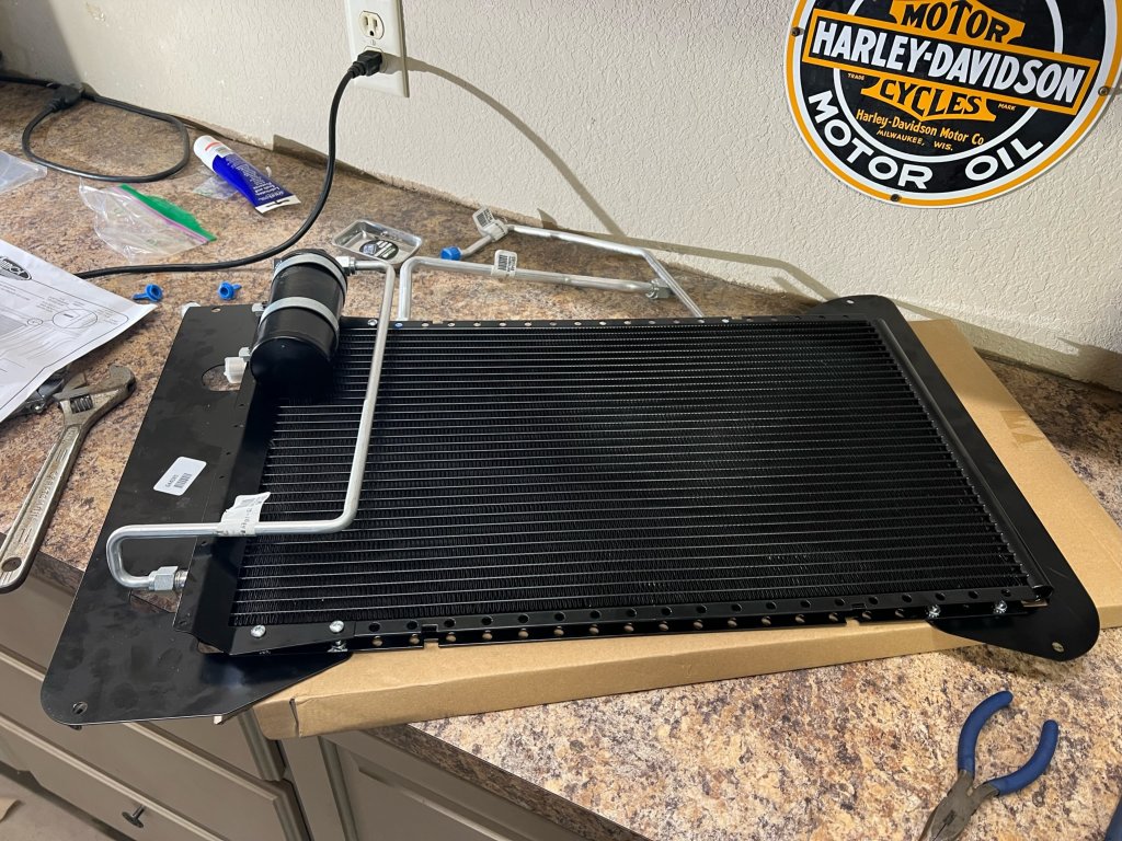

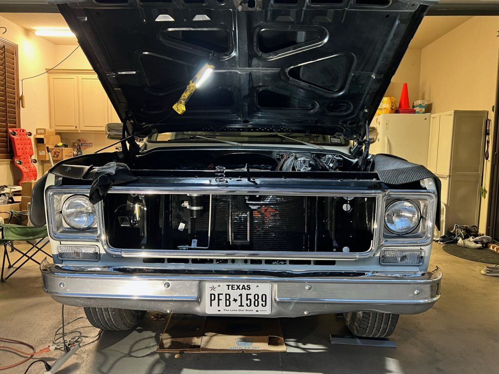

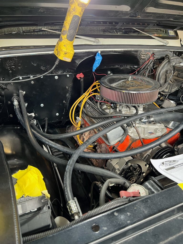

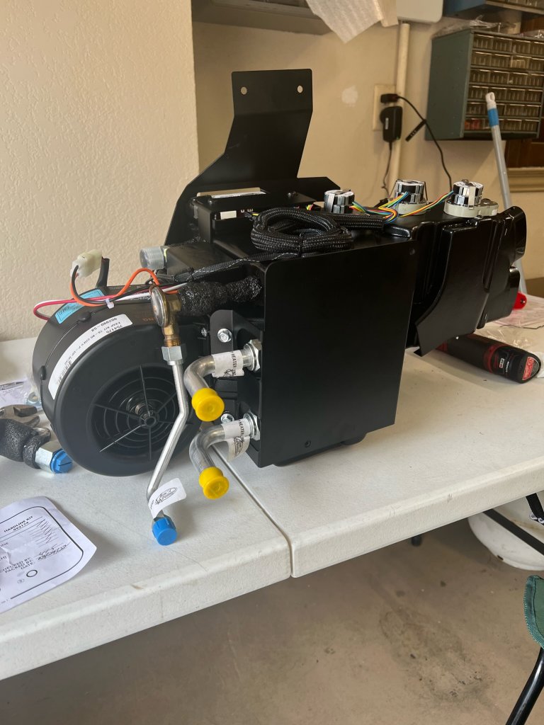

We did vintage air 1 year ago. Absolutely the way to go. Easy instal and works great. Engine heat is used and it has defrost and floor vents. We did it over a weekend and it performs as advertised. Great customer service and tech help if you need it.

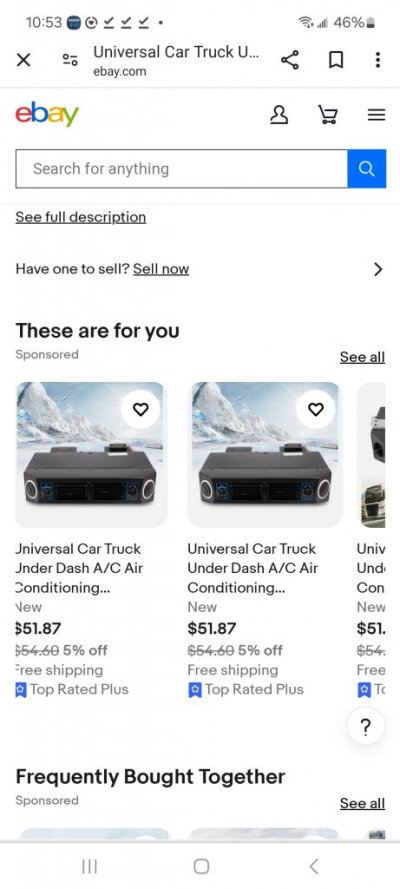

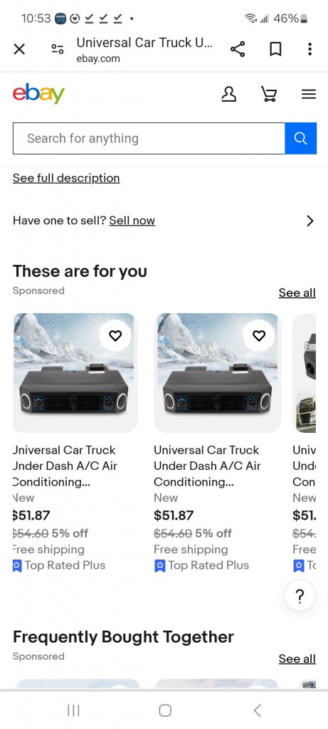

@mikeoverland I'd do something like in the pic I'll post,a universal underdash evaporator/fan combo scout the salvage yard for some brackets and a newer more efficient compressor and condenser. Have some hoses made. I am skeptical of the efficiency of a 12v air conditioner but also just as bothered by the 70 amp draw.I suppose you can go with a seriously upgraded alternator,or add a second alternator and battery.To me a home brewed conventional A/C system makes more sense.

thanks for the advice. I didn't realize that they pulled 70 amps! gertting a bigger alternator is not a problem but 70 amps is a fire waiting to happen.
