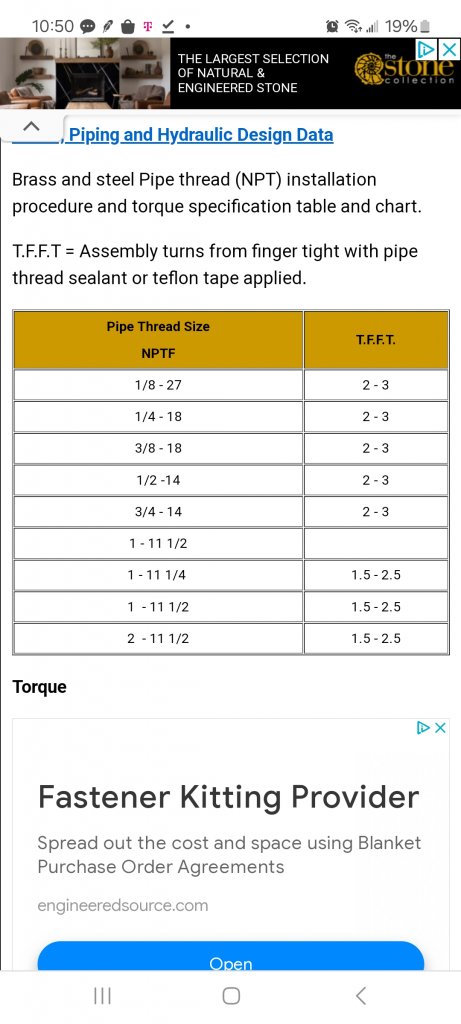

Also since npt is tapered,overtigjtening results in cracks in whatever you are screwing into. There is no set torque setting it is,so many threads engagement plus x amount of clockwise turn. I don't remember the formula. But it is worth looking up. I've done so many over the years it's now just by feel like setting pinion preload eventually you just know it by feel. I looked it up for you,it's in the pic,stay on the loose side if it leaks you can snug it more.
