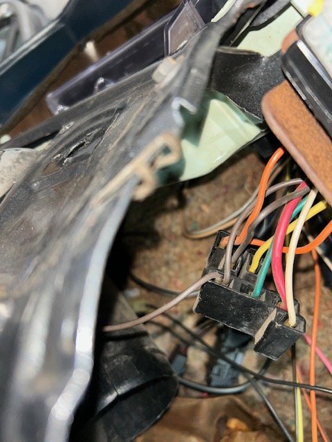

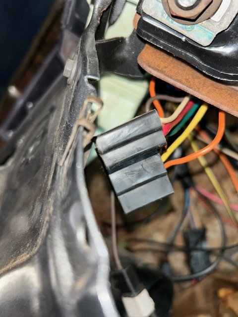

i am replacing the headlight switch on my 86 k5 and i have an extra wire im not sure about,the brown wire in the plug has two wires in it, one going to the running lights and one thats about4 to 6 inches long with a male spade connector on the end which isnt plugged into anything, this definitely looks stock so im pretty sure it wasnt spliced in, any ideas what this is supposed to connect to? i cant find anywhere that looks like it should plug into

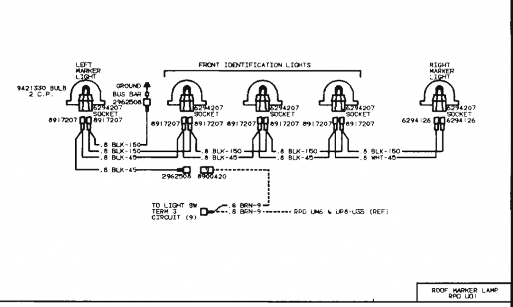

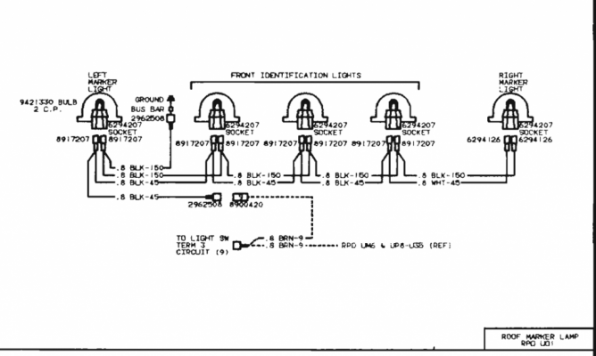

maybe something like roof marker lamps??

that would make sense, im pretty sure that was an option
