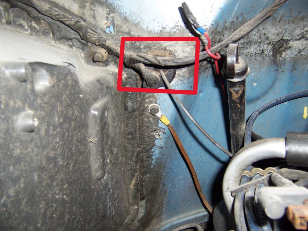

85 has a vacuum supply. However most vehicles will default to defrost if vacuum is lost.

Also make sure the vacuum is connected in the engine compartment. My 1989 has similar issue (although the A/C doesn't do much anymore) with the routing doors. Turned out the vacuum line ging through the firewall was broken, so none of the diaphrams that move the doors did anything. The heat blend door still worked because it is cable operated.
