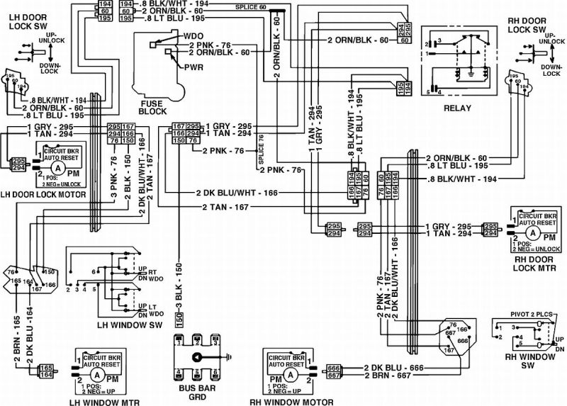

Hello everyone. I am hoping to get some help here. I am getting pretty desperate. The power window on the passenger side will go up but not down. The driver side window works fine. I replaced the switch on P/S but still now working. I also replaced the switch socket. I can't find a decent wiring diagram anywhere. Does anyone know what my problem could be? I have worked with this for days and it's getting very frustrating.

Check that you are getting power to the window motor at the plug with the switch in the down position. If you are its a bad motor if your not its a bad switch or wire.

would this help
