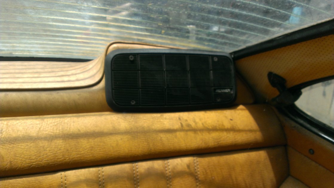

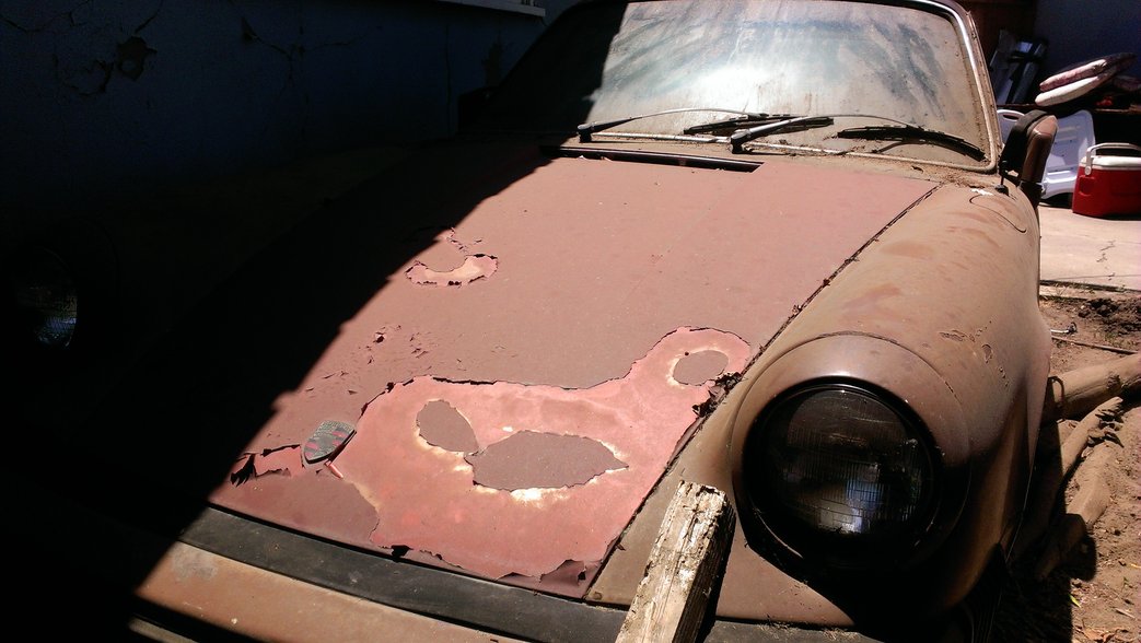

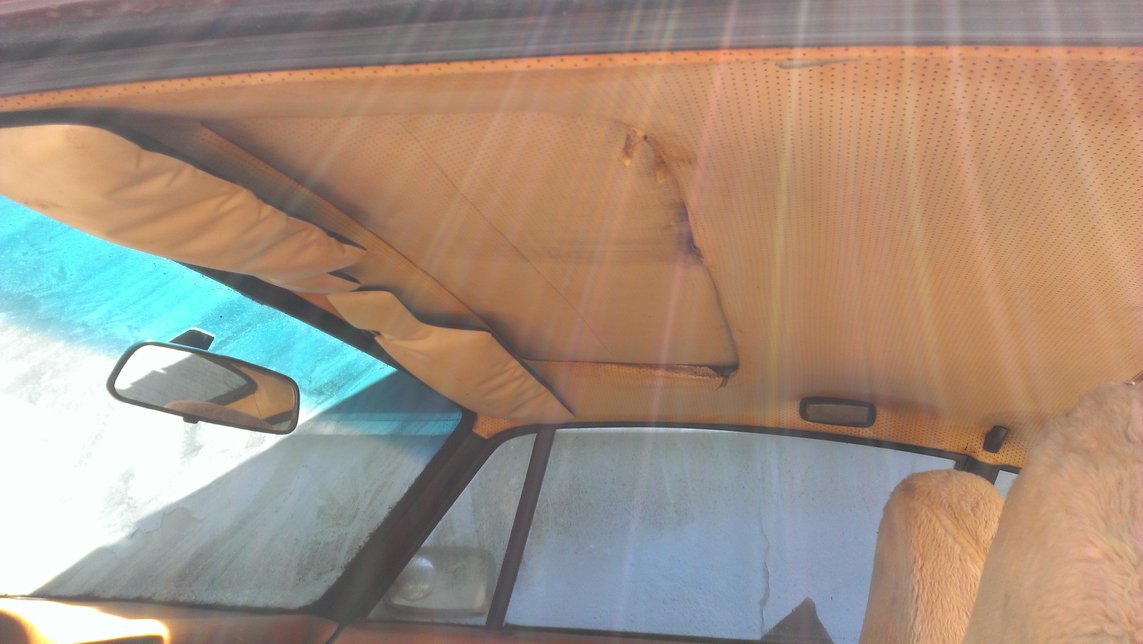

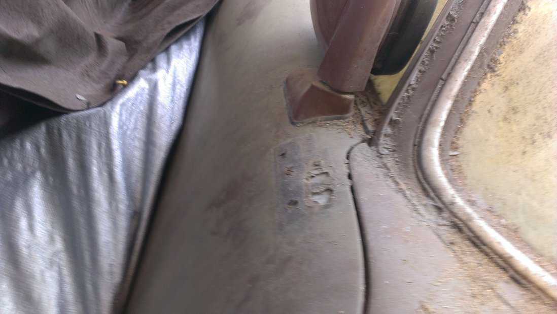

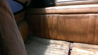

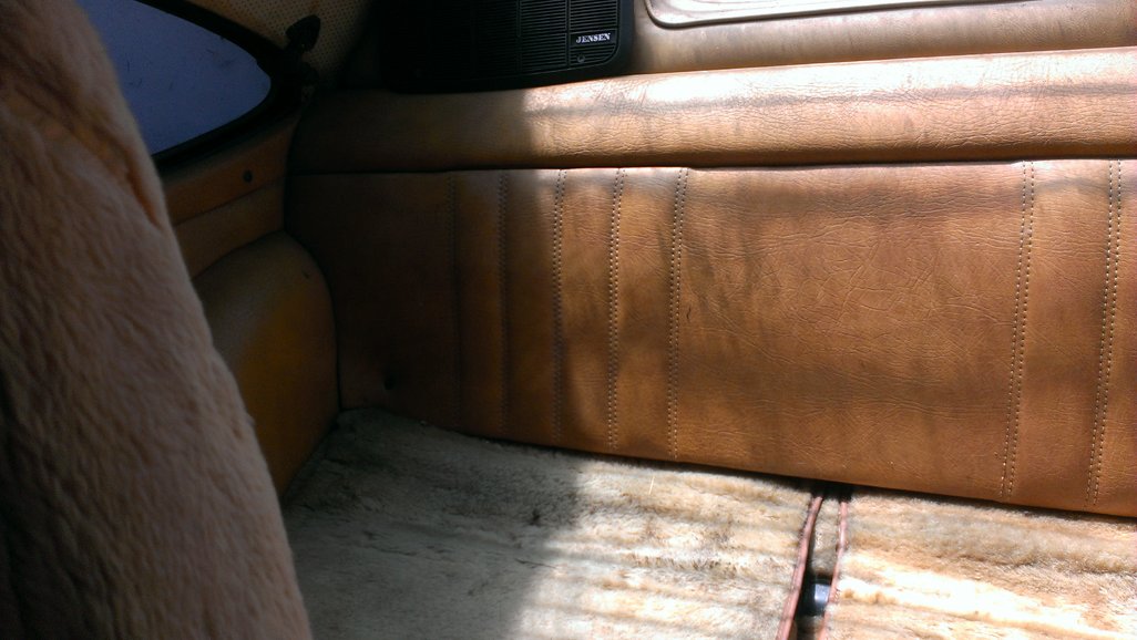

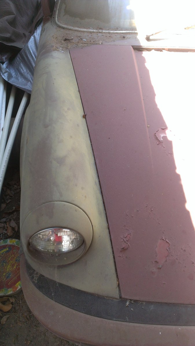

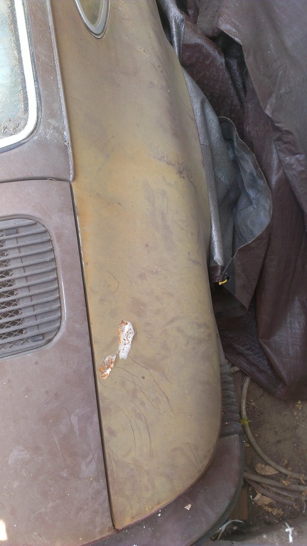

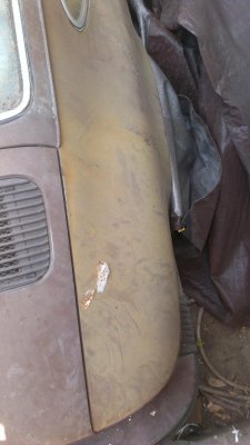

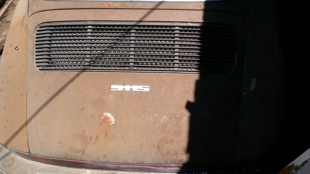

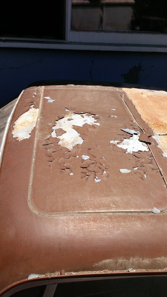

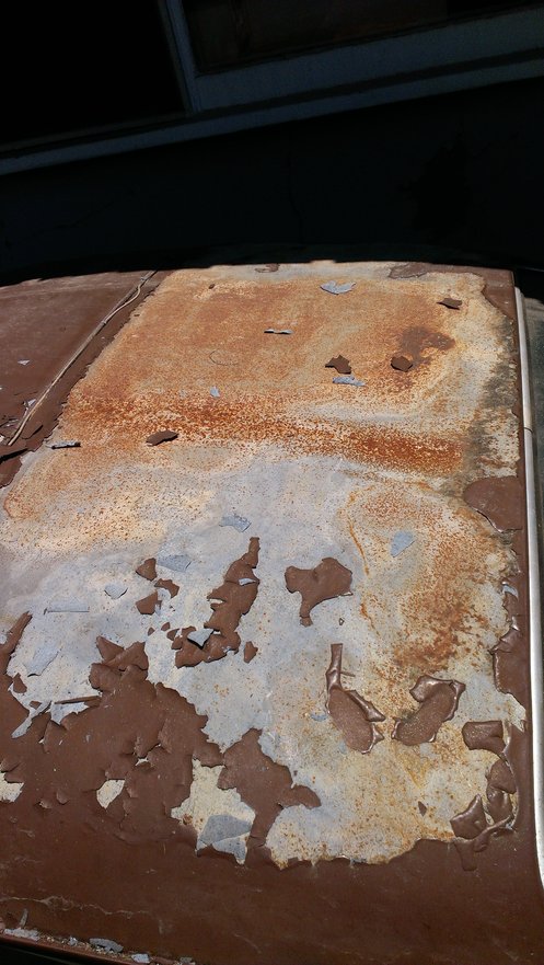

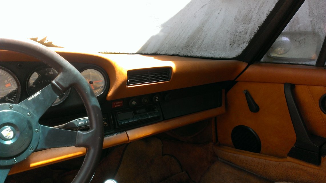

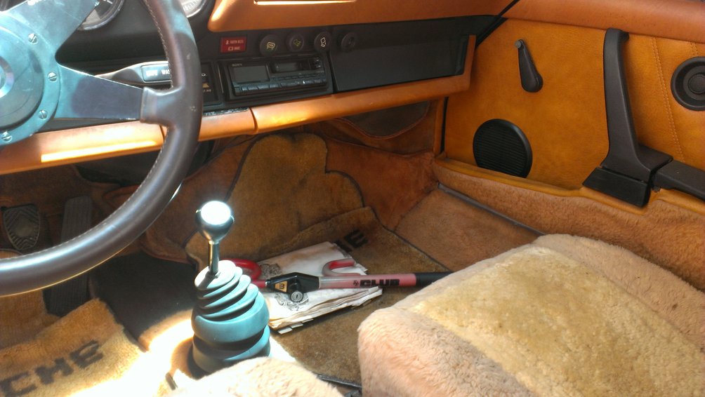

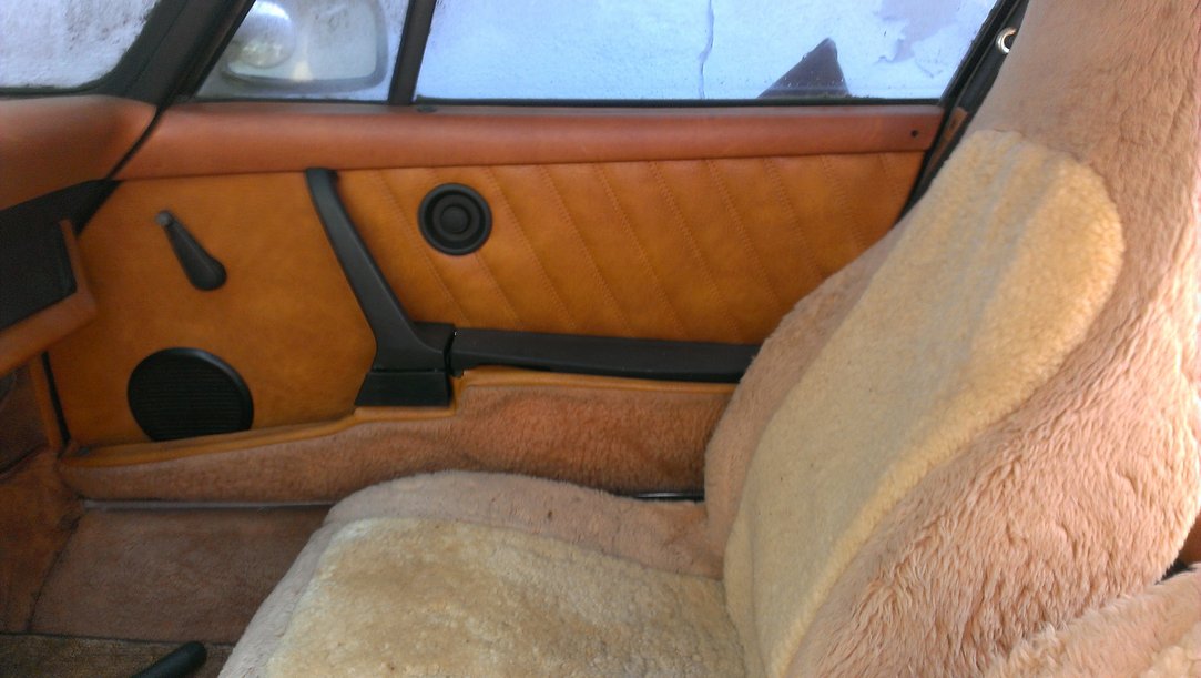

Some pictures

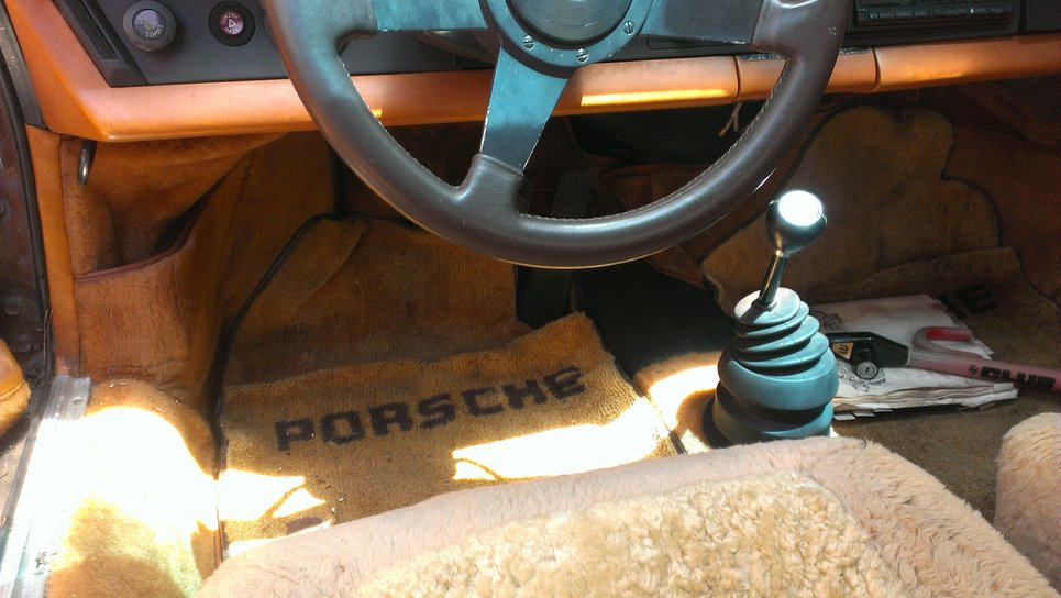

more pictures

Any preferred primers for the old galvanized panels? Doesnt have to be pretty, but definitely needs to protect.
Sent from my SM-G935P using Tapatalk
1987 GMC Jimmy
Automobile Hoarder
Jan 23, 2016
5,848
2,389
Mississippi
Jesse
V1500 Jimmy
I'm not as metallurgically inclined as some of the other folks, but I think any run of the mill acrylic primer would be fine. I think the key to a paint job that works and lasts on galvanized metal is doing really thorough prep work so everything binds well and doesn't start peeling and flaking prematurely.
