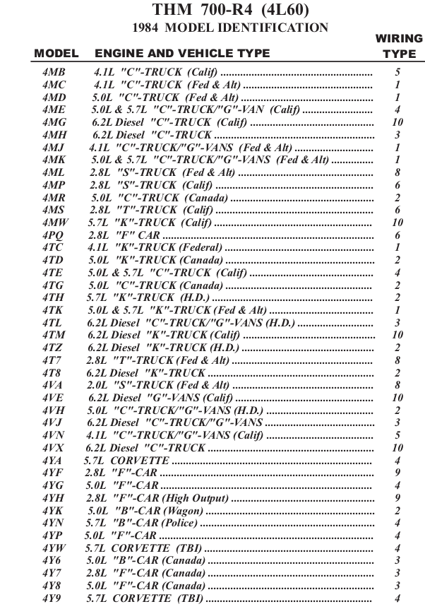

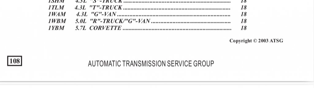

1WAM164A
1991 4.3 L "G" Van wiring type 18 - "164" (numerical day of year made) on A-shift
